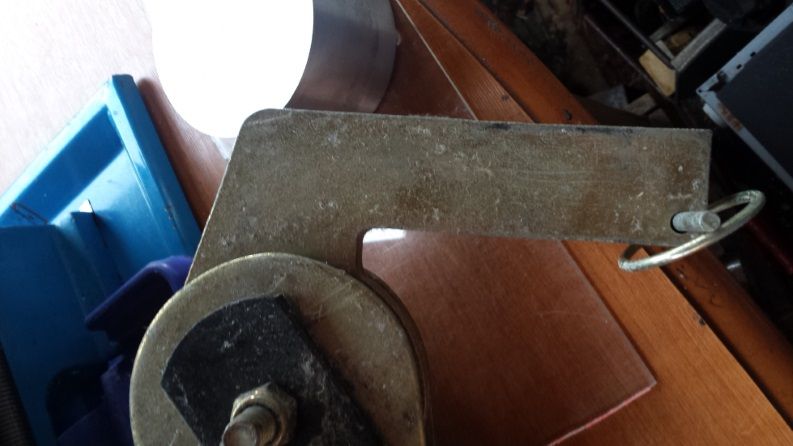

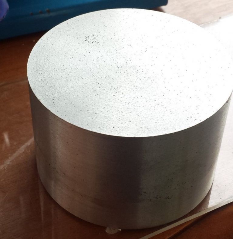

Uploaded a couple of pictures myself (slug) and i think i have found a suitable toolholder, the bracket from a caravan stabiliser. 12.5mm thick.
Before
After
Toolholder?
Apologies if the picture are messed up. My first attempt at pictures on here.

Just had a closer look at yours and expected mine to have all those pock marks in the casting but after just a small skim to get it all fairly true, most of them have gone. How do you get a cleaner casting without those marks?
I do not remember using any flux or degassing so maybe there is the answer?

Is the slot angled to adjust the toolheight? What secures it into the slot? Any other pictures?
I dont think i have any scrap around that size, i wonder what else i may have?

Ball turner looks an ideal solution. I wonder what i can use to make the toolholder?
Ideas on mounting a tool holder without using a mill to cut a slot into it? And i do not fancy filing it
