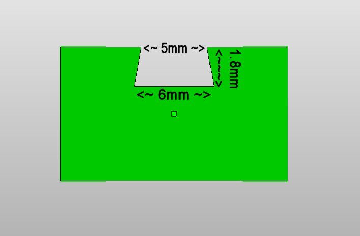

Thanks, I have seen some of his video's but not that one. Thats ideal for a small holder, what would you do with a larger piece though say 60mm or 100mm long? Filing that maybe an issue?

I have a dial test indicator and whilst rotating the dial the dovetail holder snapped off. More a case of cheap junk than heavy handedness. The threads on the holders shaft had a very loose fit and it would tighten up and you turned the outer rim. Cheap metal and a tiny contact area left from where the dovetail cuts into it, sure fire fail point.
I thought i would make another holder, a larger aluminium bar would be better to start with, leaving some material left so it doesnt break again.
That got me thinking how do you cut a <5mm dovetail slot in steel? High spindle speed and slow travel? Would you slot it then cut one dovetail at a time? Or would cutting both offer better stability?
How would it differ between say a small sub 15mm piece of steel and then the same dovetail in a 100mm long piece?
