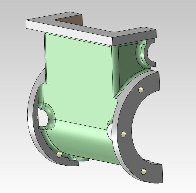

One technique I have learned, which is very useful for complex parts, is to take a screen capture after each step, and paste that image into a photoshop program.
This leaves a quick visual paper trail, and should things go wrong, you can glance at your method, and generally figure out a new approach (if needed) quickly.
This paper trail is also very useful if you put a model away for a year or so, and then come back and start working on it again. I can quickly refresh on the approach that I took on any given part.
Here is a paper trail on a part that I modeled (a bearing support block).
Complex models may be intimidating at first glance, but the trick is to break their creation down into one simple step at a time.
Like climbing Everest; you don't jump to the top in one big leap, but rather take one small step at a time, and rest often for recovery.
