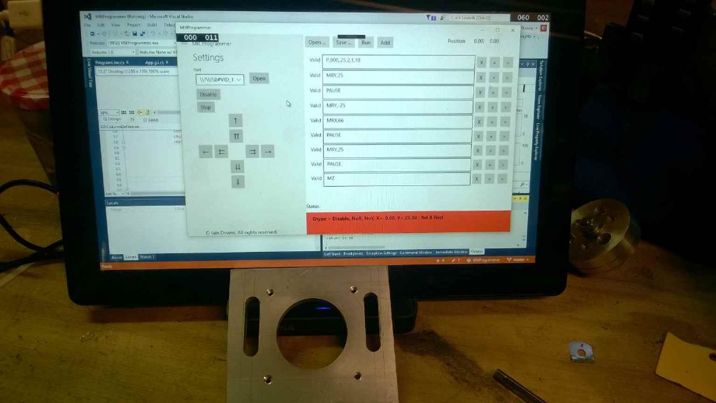

My first CNC milled piece!
I've finally got my arduino progam, Windows 10 program and hardware working well enough actually do something with it. This is a plate to replace the NEMA17 motor currently driving the Y axis with a NEMA 23 motor.
The mill is only a micro, so there's no auto tool changes, no Z axis control, but this is a damned sight more accurate (and repeatable!) than if I'd done it by counting the turns on the handle!
Same plate in front of the tablet with the CNC program on it.

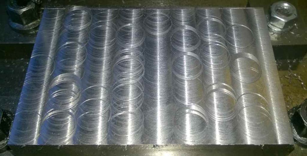

05/06/2016 11:56:40
First Prize to Neil, Jason and Dave.
The (main) cause is that I'd loosened the Y gibs and not re-tightened them. I'd forgot I;d done it.
I tightened up the Y gib and put the speed back up to 2K rpm and this was the result.
Although it looks like I've actually carved semi-circular runnels in the metal (mild steel from m machine metals), it's actually pretty flat. my dial indicators shows a few microns clicker as it passes over the mark.

04/06/2016 18:38:13
Interestingly, I've run the cut the other way as per below.
Which is much worse.
As far as locking the spindle is concerned (CMD10), I'm not right sure how to do it. there's a hint I saw somewhere about a locking bolt on the bottom right face of the headstock, but if that's the way you lock it, then it's pretty damned stiff and seems to have not much effect on the spindle.
The Z axis (the riser) IS locked - that's one I have learned.
The ridges are caused (I think) by the table being out. See my other post...

04/06/2016 16:57:05
Why do I get 'crop circles' when face milling?
Mill is a CMD 10. tool is a 10mm carbide mill from ARC depth of cut about 4 thou / .1mm. The first picture shows the result of a manual cut.
The crop circles are plain.
I'm in the process of converting the Mill to CNC (of sorts) so the next picture is with the same piece of metal with a power feed (about 4mm / second and whole stop at 100 steps / mm)
Dissapointing, eh? then I switched to 1/4 step (should be much smoother - and certainly was by sound) and down to 2mm / sec.
This one seems much better (the ridges are the subject of my other question).
However, here is a second run at the same spec
So what causes the crop circles and how can I adjust the mill to avoid it.

One of my goals was to get my 2 Axis CNC conversion on my little mill finished.. I kind of managed this and it's working sort of, but I made the mistake of deciding to convert my program that drove it to Windows 10 (so I could run if from my phone). Don't ask my why. And don't ask me why I thought that Microsoft for once would have moved versions without totally reworking everything and requiring you to learn it all again.
And my arduino code was flawed too
Still it's going (of 5 days later than I expected) and I now await the next delay on my project with anticipation
(If you're wondering why the motors are different - I started off with a nema 17 then decided I wanted to use NEMA23 - with double ends for manual control. I've not got round to building the brackets for the second NEMA 23 - though I may try that on the Z axis next..)
