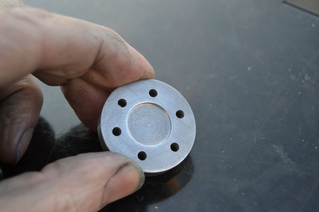

06/09/2015 21:05:38
Hi,
I had intended to start on the valve chest today but after reading earlier advice I've decided to put it off for a few days till I've had a think about it The cylinder head looks fairly straightforward so I chose to do that instead.
Firstly though I wanted to cut the steam passages into the end of the almost finished cylinder. It's a simple matter of cutting a 2mm deep slot linking the steam inlet to the cylinder at either end.
Without access to a mill I decided to use a small Dremell type hobby tool. It's not pretty but should do the job
Now for the cylinder head, basically it just involves machining a 5mm thick disc with a slight raised centre on one side to locate in the cylinder and drilling holes for securing bolts.
Firstly I turned the the stock to size and used the tool to scribe a light 12mm radius witness mark to position the bolt ring later.
As I machined slightly more off the cylinder walls than the plan required I thought it best to have a quick check that 12mm radius for the bolt ring looks ok.
Sure enough a ring 24mm in diameter looks to be fine.
Although not on the plans I thought a slight recess on the outside face would enhance the appearance a bit. I also wanted to see if I could fit a ring of 6 bolts in rather than the 4 on the plan.
What seemed like a simple idea proved to be more awkward than I expected, I'd overlooked the fact that the tool I was using had insufficient clearance and it wouldn't allow me to get a square corner in the recess.
I thought a parting tool might just about manage as I only want to remove about 1mm of aluminium but even raising it a shade above centre it wouldn't clear either.
Hopefully this will do the trick.
At last !
The other face requires a raised portion 1.5mm deep to fit flush into the cylinder.
If I can get away with it I'd like to secure the head with 6 bolts rather than the suggested 4 so marked the end and scribed a very rough free hand approximation of where the bolts will lie. Although a very crude method I'm satisfied I can get away with 6 holes.
Having drilled all the holes I do like the appearance and think the recessed centre adds to the look but I did get 1 or 2 holes slightly off centre.
And how it would look with hex head bolts.
I'll have a think about it overnight before drilling the cylinder.
