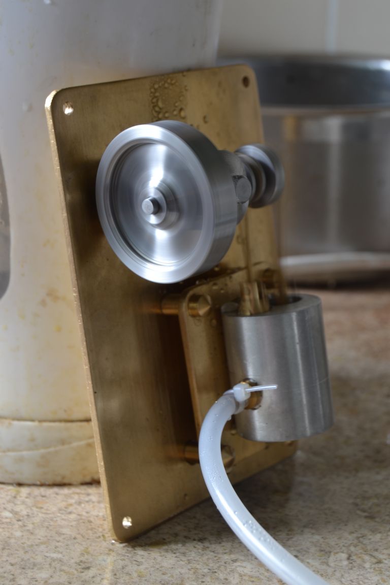

Here's a short video of it running on live steam, it can be seen how it runs better when upright.
I'm inclined to think it's an issue of water in the cylinders rather than friction problems (when not connected to the steam line it spins freely with little friction)
The Kelly kettle I'm using as a temporary boiler throws out a lot of water and think that's a lot of the problem rather than the engine itself but would be interested what others think is the cause.

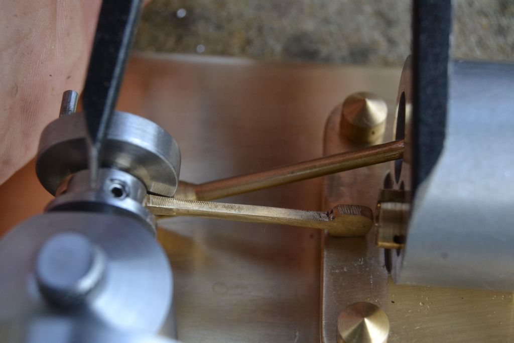

I set about trying to finish the engine yesterday and hopefully give it a test run.
Firstly I needed a better wrist pin than the temporary staple I was using. It involve turning a piece of brass rod down to about 1.5mm but with care that shouldn't be a problem.
At about 2mm the rod is starting to flex and the tapered cut I'm getting becomes apparent, thankfully the Poundshop sell these blue travelling steadies at 6 for a quid in the biro section
The taper seems to have gone
Eventually I arrive at this,
1.55mm and just right.
Cut to length and the end lightly peined over all seems ok.
The wrist pin needed to be just short of the end of the cylinder at maximum travel and have a 3/16 stroke, so I'm hoping I've achieved that with sufficient accuracy.
With the wrist pin done all that's needed now is a few spacers for the axle and then a test run.
I'm satisfied this is the alignment needed, so I need a spacer with a disc to keep the eccentric in place then possibly another one between the eccentric and crank and finally a small one behind the fly wheel may help.
A steel bar turned at one end to 16mm (the eccentric retaining disc), reduced down to a smaller diameter for the spacers and drilled to accept the axle.
A bit of a makeshift idea but I reckon the eccentric disc/spacer need to be 6.5mm
So using this crude method I cut small reference grooves in the work piece marking the parting cut position. I did the same method for the other spacer hoping I'll get 3 components in one procedure.
Parting tool at the ready and here we go, buy 1 get 2 free.
I took the next photo at the wrong time, it should show the tool further left to part off a disc for the eccentric, but you get the idea.
I end up with these 3 and just a bit of filing and tidying up to do.
Looking like a 'proper' crank assembly.
Well does it work ?
I rigged it up to a Kelly kettle and aquarium tubing and although it coughs splutters and hisses it does kind of work.
The eccentric rod has a bit too much lateral movement and the valve piston is a shade too small in diameter. the result is steam escapes past the valve as it wavers in the cylinder.
I'm going to file down the eccentric today and make a better fitting valve piston in the hope of rectifying what I think is the main issue.
I'm confident it will work though, the valve although a bit sloppy in side to side travel does seem to operate properly.
Peter.

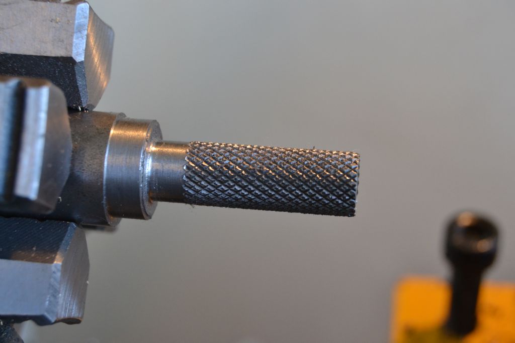

My postman arrived with my knurling tool and grub screws today so I'm now in a position to hopefully complete the engine.
I've never used a knurling tool before but after a quick look decided to put it to work on a few trial runs before making the bearing oil bolt.steamer 13 (1).jpg
After a few tries using different speeds and depth I ended up with this.
It looked to me worth keeping as the finished product so set about turning it to size and cutting a thread. Since I wasn't able to cut a thread right up to the head using a die I decided to turn a plain shaft slightly undersize just beneath the head. I hope this will allow it to seat flush on the housing once tightened down.
The remaining stock in the chuck came in handy to make a threaded arbour to hold the work whilst I turned it round to face off the head.
5 minutes later and a bit of filing to shorten it and this is the result. steamer 13 (17).jpg
So far so good, I reasonably happy with it.

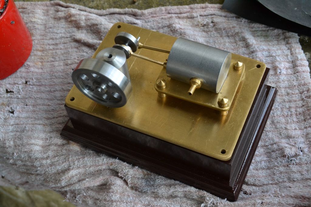

The engine is nearing completion now and there isn't a lot more I can do at the moment.
I've ordered a knurling tool to make a decorative bolt for the bearing oil hole and a few assorted grub screws to secure a few components to the main axle. Until they arrive the only thing left is the eccentric rod and pin plus a few axle spacers.
I decided to tackle the eccentric rod get it filed down to size at the eccentric end then when I can secure it with a grub screw I'll work out where the hole to connect the valve piston needs drilling and file the other end accordingly.
The plan suggests making it using a rod soldered to a ring of copper pipe as the eccentric strap, I don't have any soldering equipment and thought I could make a better job by hand filing it as one piece from a piece of brass plate.
Much filing later it's starting to take shape.
One end just about done and a nice fit on the eccentric.
As it's a gift for someone I bought a decorative plinth and overall I'm pleased with how it's starting to look.

Peter.
08/07/2015 12:12:56
Thanks everybody, it's reassuring to know I'm not the only one who things the drawing is wrong somewhere.
Because of the way I've adapted the engine to suit my own tools and materials rather than mess about with solder etc I'm hoping to sandwich the eccentric between 2 slightly larger discs trapping the eccentric strap between the 2. I'd like avoid having the 2 discs but cant really see a way round it.
I hope that by having one of the discs and the eccentric made from one piece it will be wide enough to allow for a small grub screw to hold it on the axle and allow for timing adjustment. It should be a simple matter to trap the other disc between the eccentric and bearing post.
Working in new money I reckon the eccentric needs a 2.5mm throw and I just need to make sure the furthest offset part of it is at the same overall radius from the axle as the outer discs so that I have the width of both parts to tap for the grub screw.
Does that make any sense ?
Peter
Edited By Peter Nichols on 08/07/2015 12:14:31
