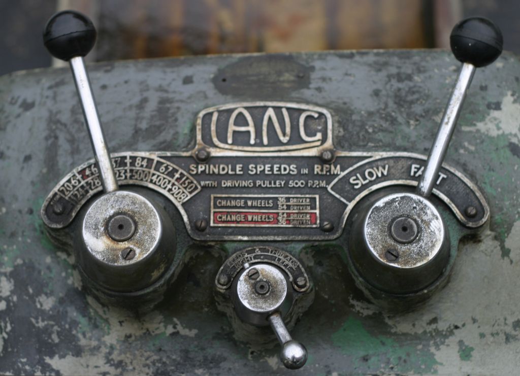

Frank, Many thanks. There is no obvious lever to set between lead screw and feeds power shaft. The only control lever addressing these is a right/left reverse feeds/threads lever on the headstock, beneath the main spindle speed levers. This has left and right, and, I am guessing, a neutral in between, whereby the gearbox is disconnected from the headstock. Here is a picture showing it set to 'right'.
Apart from this, there is nothing on the gearbox itself, aside of two main positional levers which set the six speeds. Only Lang guidance in the Owner's Manual says that when not using the lathe for threading, that the change wheels on the external part of the gear box must be left disengaged. This suggests to me that the lead screw is normally unengaged, and that it only comes into operation when it has change wheels attached. That might suggest the spindle is primarily connected not to lead screw but power feed shaft.

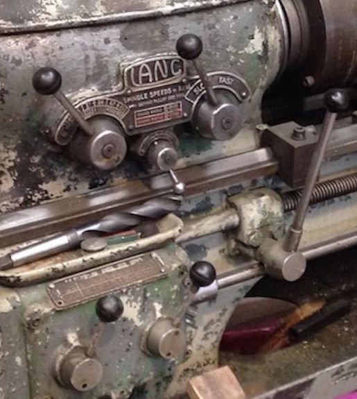

Here is another shot, which shows all control levers together - two main spindle speed levers on headstock, little feeds/threads lever between them, two main speed selectors on gearbox, and main clutch control lever. With prime information on the gearbox information plaque being only feed and cut speeds, my initial conclusion is that the lead screw does not work at all without external change wheels mounted, and that power from the spindle goes primarily through the power feeds shaft. I will know more next time I see the lathe in a couple of weeks from now, when I will take off a few covers, and see better what troubles us.

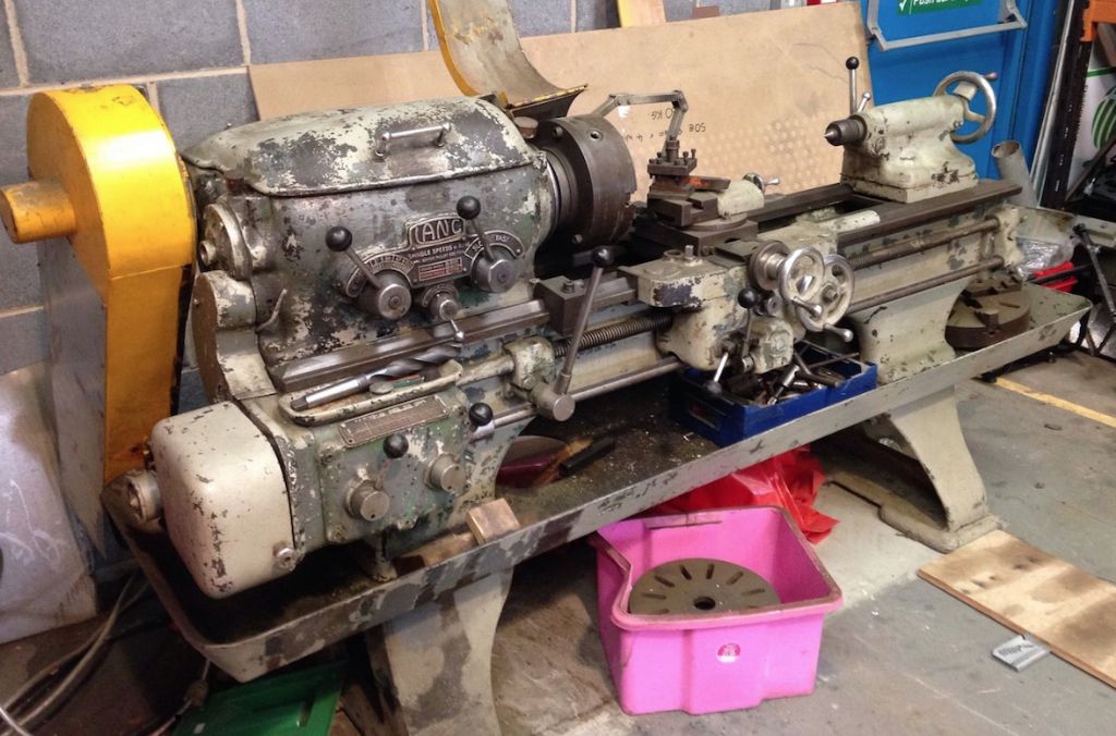

Here is a better picture of my Lang Junior. Despite tired cosmetics, the lathe is in excellent shape, and shows no sign of real industrial use.
This was, after all, John Lang & Sons' hobbyist offering, weighing in at only 1.4 tons. It is the smallest lathe Lang made.
Everything on it is seriously chunky - the drip tray weighs over 200lbs, and, covered in oil, it took three men to manhandle it. The tailstock weighs about 100lbs.
It has an extra foot of bed on standard, @ 7 ft, and came with three chuck/faceplates, and a whole estate carload of cutting and drilling goodies, and tailstock chucks, centres, etc.
Bazyle, many thanks, and I will try your diagnostics when I am next with the lathe in a few weeks.
Phil & Brian - I think we are inching forward on the gearbox status quo.

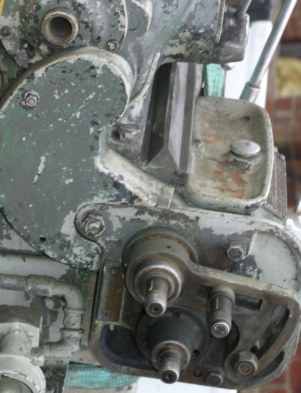

I have taken possession of a new 'old' lathe, a very hefty Lang Junior 6.5" from the 1950s, and have a query as to gearbox change wheels. The lathe has twin systems, a fixed set of wheels from headstock down into the gearbox, which I have not revealed yet, behind covers visible in this picture, and I do not know quite what they connect to in the screw cutting gearbox.
Then, there is further provision for externally mounted change wheels, to the exterior of the screw cutting gearbox, a banjo and three mounts for wheels.
I have no change wheels with the lathe, and from dry, dusty state of the architecture here, I am uncertain this lathe ever had them. Neither does it have a thread dial indicator.
Only guidance from a Lang Junior Owner's Manual states that change wheels were used for Whitworth and Metric threads, and that when the lathe was not being used for screw cutting that these were to remain unengaged.
This has suggested to me that the inner wheel train connects down not to the lead screw but to the power shaft, but it is by no means certain until I do a bit more dismantling.
Have any members any knowledge of this lathe, or such a system, which seems to me a bit of an oddity.
It is not easy to understand this, without further steps.
The gearbox information plate has no screw cutting guidance, only cutting speeds, surfacing and sliding.
It has six speeds, set by twin levers, and runs in a full oil bath.
Any help will be much appreciated.
Many thanks.
Chris Mills.
