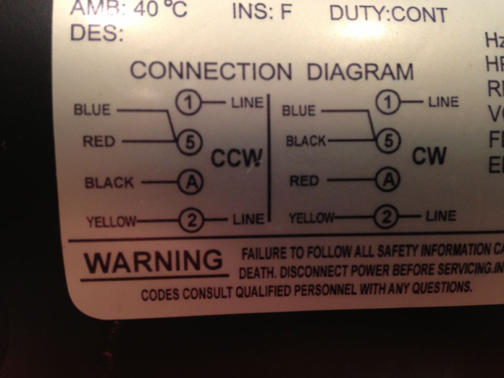

Posted by Glen Morgan 1 on 04/05/2014 00:09:14:
Connect the incoming supply of live and neutral to 1 & 2 - e.g. live to 1 & neutral to 2 (or vise versa)
The rotation is then determined by which colours are bonded together on terminal 5
Don't forget the earth to the frame. They often omit earth connections on diagrams for clarity and presume you will automatically connect it.
Get it running in one direction or the other first to check you have not 'butchered' the motor (unlikely but possible) by previous wrong connection.
Once you have done this let us know and we can then sort out the reversing issue by use of a multi pole rotary switch by altering the connection permitations that configure 5 & A
Have you got a multi meter or a continuity tester.???? - You will probably need one to 'bell out' the open and closed sides of the switch.
Nick
Edited By Nick_G on 04/05/2014 05:48:25
