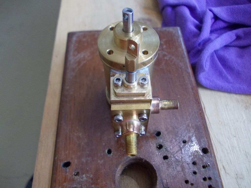

21/08/2017 08:05:01
I have removed the steam chest cover to observe the operation of the control valve as it moves back and forwards. When it is in the forward position should the steam hole on the right be open or closed ? And when it is in the rear position should the steam hole on the left be open or closed ?
I have measured the hole positions and the control valve but something is not quite right. I may have to desolder the steam chest and start again.

21/08/2017 04:09:08
I have re-read the instructions concerning the control valve cover and watched that instructional video again : I had the cover on the wrong way ! The spigot goes inside the steam chest not outside as I had it positioned. Thinking I had solved the problem, I then tried it in the new position...just the same. I also tried the other steam chest and the other cover...just the same.
I am really not sure what is going on here now. There is nothing else to do but make a new control valve cover and see what happens. The engine is 98% complete but unless I can get this part to fit properly then it will not run.
