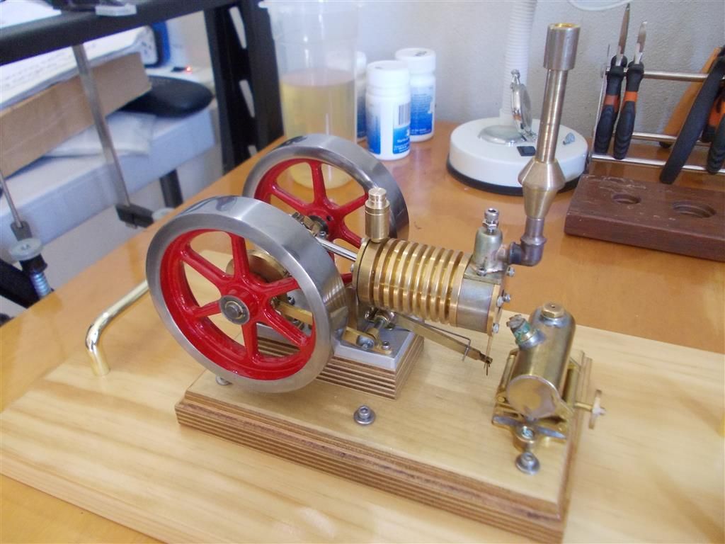

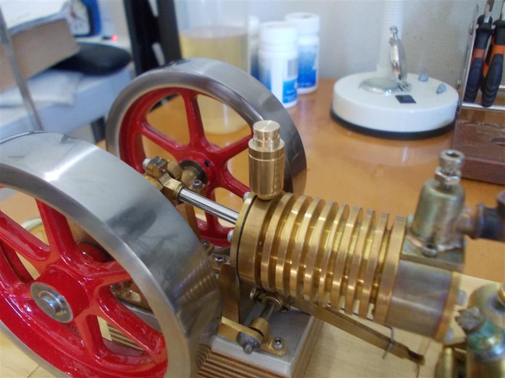

I made a lubricator for this engine as obviously it does need oil on the piston and cylinder to work effectively. I even made a ''hat'' for the lubricator ! The engine looks more balanced now ; it looked a bit strange before.
There was always the chance that I would damage the cylinder bore by doing this. I drilled and tapped for M3 then carefully removed the excess metal from around the hole using some 2000 grit wrapped around a piece of dowel. I thought I had done a good job but even that small adjustment has mucked things up. I seemed to have lost my ''pop'' sound for the engine so I guess I will have to make another, tighter fitting piston to give a better seal. These things are so fussy !
