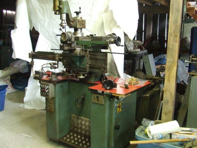

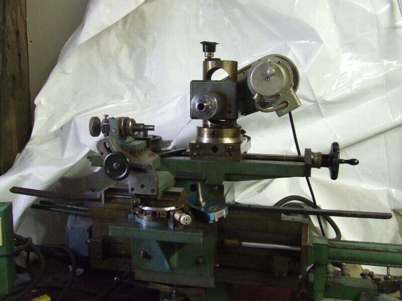

Hello all
I recently saw these two machines for sale near Hamilton, Ontario. The seller describes them as Vertical and Horizontal universal Milling Machines, made by Tourdiamants of Switzerland.
Looking at the pics, I can't identify how they work or what they are designed to do! Lathes.co.uk has nothing on this manufacturer, and a web search brings up nothing, so does anyone have any ideas what they actually are?
The seller also has Hauser and Sip no.3 jig borers and a Kneller lathe for sale, so he is clearly a specialist toolmaker.

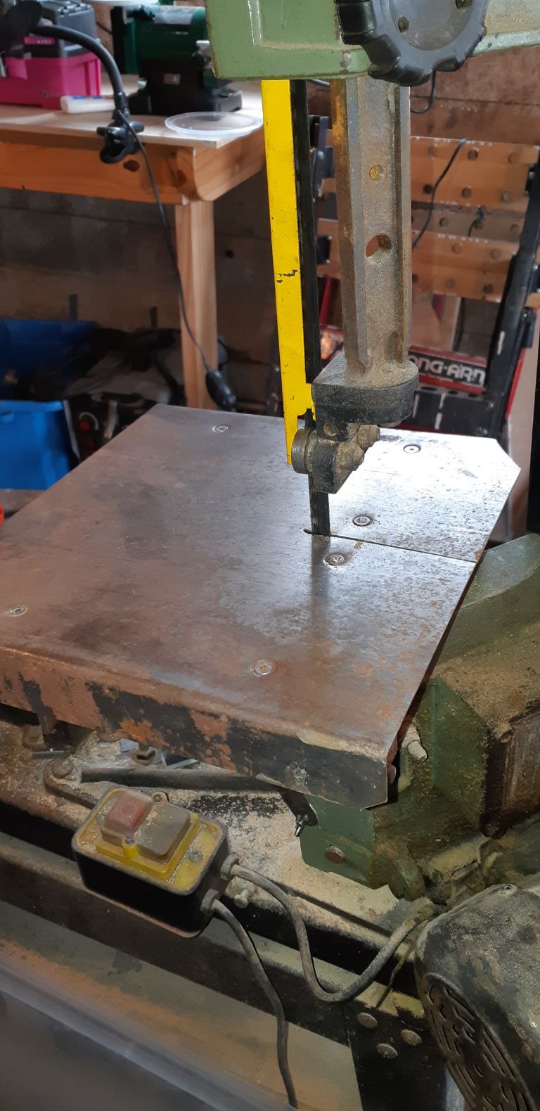

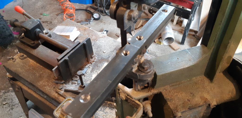

20190331_151540_resized.jpgI have an old warco 6" metal bandsaw. It's not the 'standard' one that everyone sells, but it has a swivel feature for cutting at angles. It also came with a small table for use when the machine is vertical. I lost the original table in a house move ages ago, so I made a new one. I think it might be possible to modify the more usual non-swivelling type. I have more pictures in my album.20190331_151205_resized.jpg
I remember having to machine the end of the casting to make sure the table was square to the blade once the table was on. Apart from that it was fairly easy. Apologies for the really crappy workshop.
Hope this helps

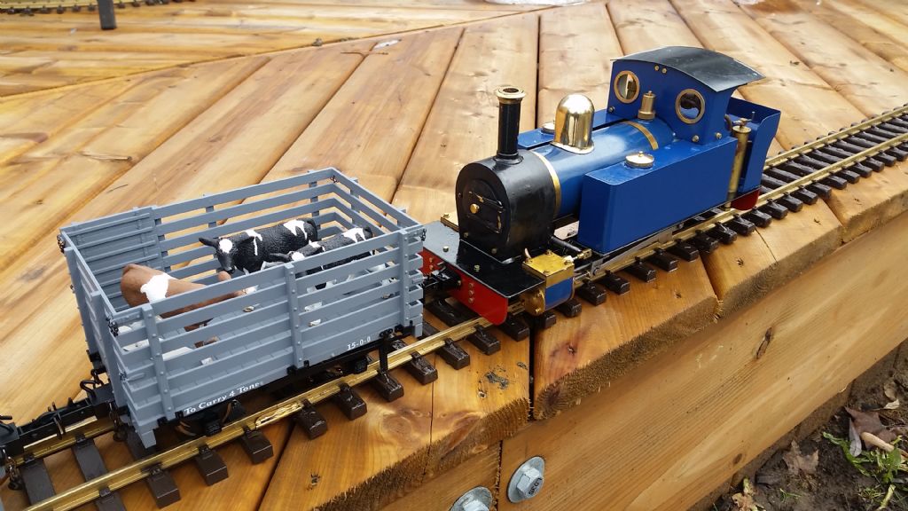

If you are looking for something one size up from the Cracker, I have just finished a revised version of the `Homemade Dacre` by Erik-Jan Stroetinger. If you google the names, you should be able to find free plans in AutoCAD format. I revised the drawings and expanded them for the imperial sized stock and fasteners available in Canada and to include all of the bodywork which isn`t shown on the original drawings.
On the Fergus Light Railway, Ontario, Canada
If you`d like to send me a PM I can get a set of plans to you in PDF format.
I have a whole bunch of images and videos in my Photobucket album:
**LINK**

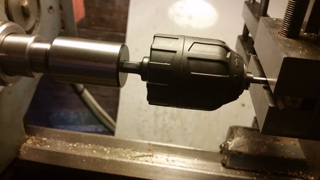

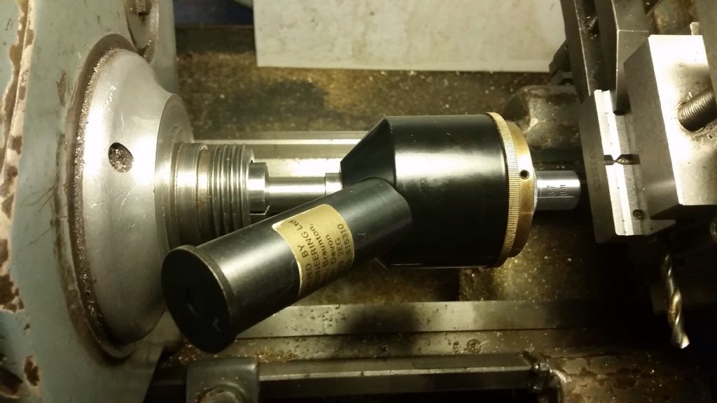

I don't have a Milling Machine, so I use the MT3 taper in my Boxford headstock pretty much all the time. I've just spent a happy 2 hours in the barn swapping out an 'Optiset' centring microscope, a centre drill, a #50 drill and my crappy tapping tool 128 times, making the cylinder cover holes in four G scale loco cylinders.
Optiset
Optiset in a 1/2" MT3 collet. (Does anyone else have one of these? Got it off ebay ages ago)
Threading
Crappy tapping tool - just an MT2 blank arbor and a drill chuck from 'Princess Auto'

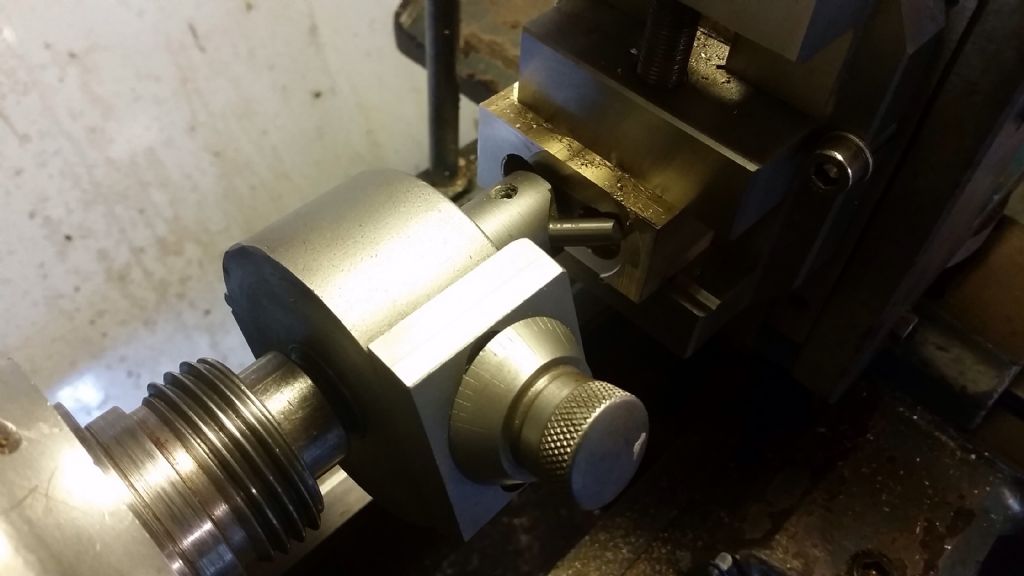

Flycutting
Another eBay bargain - nice little boring head, being used as a flycutter.
