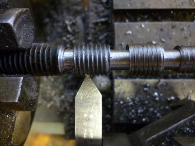

Thanks Hopper, I will try that method once ive practiced a bit more now I know the correct topside angle set-up, will put some rake on as suggested JasonB.

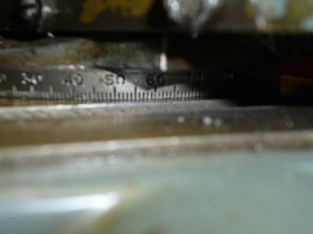

Isnt knowledge a wonderful thing! Thanks all for your time/help. Its now WORKING. see picsnew 30 deg1.jpgnew 30 deg 60 deg on topslide scale.jpgnew 30 deg 2.jpg

doing that NOW it reads 29 on the circular topslide scale at the mo

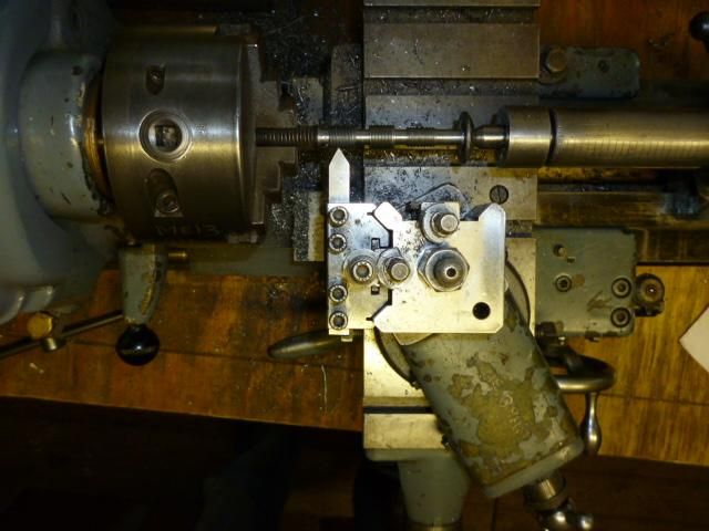

I thought I had ground the angle (60*) wrong so re-did it several times, also used 60* indexable tip got same lop sided results.

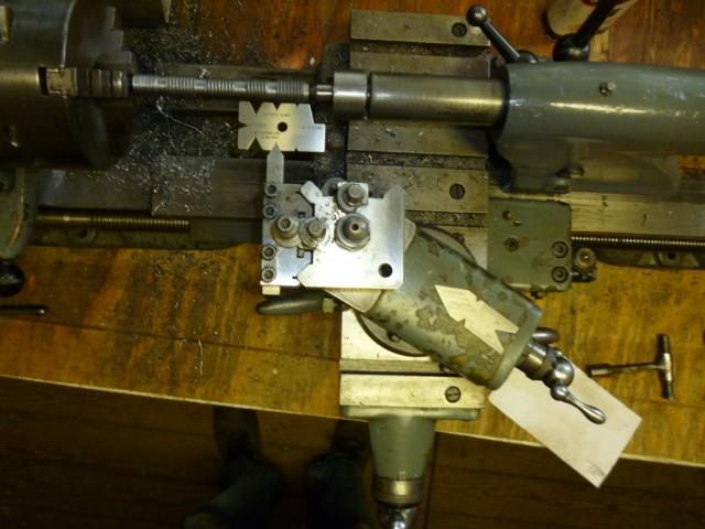

Hello Ian, yes tool is at 90* & yes I used the fishtail gauge. Will upload pics shortly.

Hello Jason, yes I have topslide at 29 degrees, ie 5 oclock, as per the link, also tried the other angles mentioned. same faltened results.

Hello all, I am trying to cut a thread on my myford super 7. I know the profile should be 60deg as in top dia, no matter what I do I get a flat sided profile (bottom dia). I have tool ground to 60 deg, topslide set at 30 deg (also tried 25, 27, 29, 35, 40 all same result) tool at 90 deg to work. Any ideas why it cuts this flat sided thread??? I have used more than one 60 deg tool, same results.

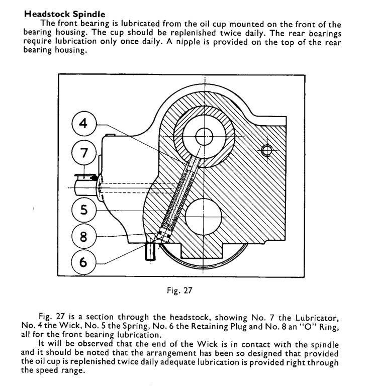

Thanks Andrew for your help, from my manual I have this dia' but cant work out where the pin will go, does the retaining plug need to be removed? Or does the allen headed screw under the spindle (marked allen key on my photo) have to be removed ie is it in the place marked 4 on this drawing??

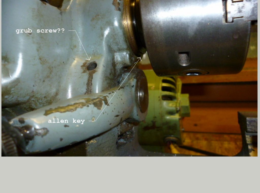

I am about to remove the headstock spindle & have read that the wick lubricating the spindle needs to be held with a pin. Does the wick sit behind this grub screw & does the pin enter the wick after taking out this allen key?
