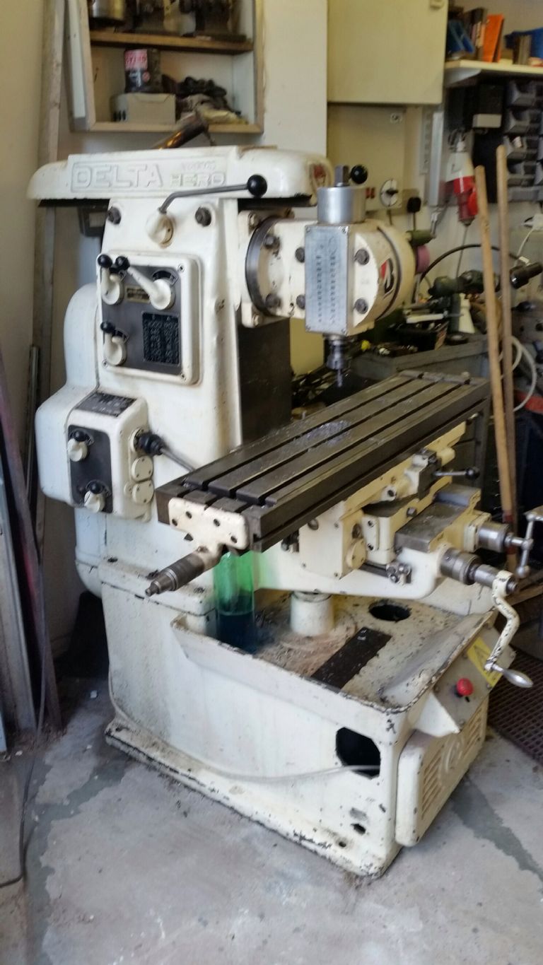

16/04/2019 16:28:29
Not had that particular mill, but have had several similar, Tom Senior etc, last one was a lovely universal Delta Hero,
Found them all frustrating due to lack of daylight, you run out of room very quickly.
Vertical heads are also pretty useless for drilling, as it’s hard to feel whats going on when cranking a handle.
And of course you can only drill vertical holes.
I wouldn’t consider a mill without a quill now, it just makes everything so much easier.
