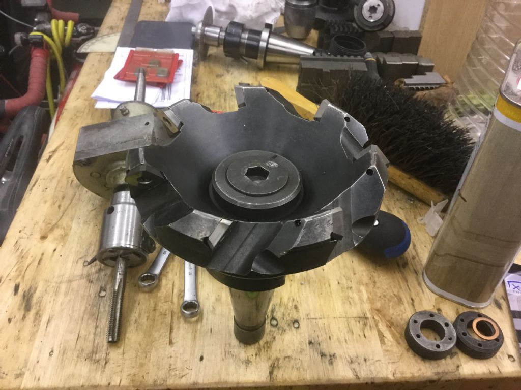

07/11/2017 20:28:41
Well i got sorted with a set of inserts for a couple of quid a piece from a very helpful and knowledgable ebay seller. Anyone needing inserts i would highly reccomend the seller Dellunn on ebay.
Just need a job to try the beast out on now.......should make the chips fly for sure smile pimg_0294.jpg

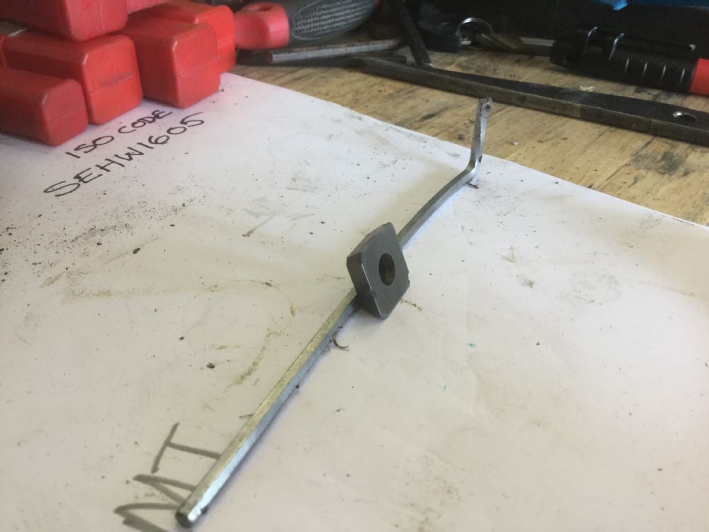

04/11/2017 20:09:53
Posted by pgk pgk on 04/11/2017 14:25:41:
Searching with a space between letters and digits gave this link **LINK**
Cheers mate, yes it's a Maydown face mill, but i hate to think how much the inserts will be from them.
I can guess at £100 to £120 per 10 crying I'm hoping to pick a set up on the cheap, as i don't even know if my mill is up to running it.
It came with a job lot of 40 int tooling, and i would like to give it a go, but at 125mm diameter i have my doubts as to it's suitability for my mill.
04/11/2017 14:09:25
A long shot i realise, but i'm after some inserts for a 45 degree face mill. Iso code is SEHW1605 they measure 16mm x 5 mm and have a csk 5mm hole. Nothing turning up on ebay, plenty of 12mm ones around. I need a minimum of 7 if anyone has any they would like to sell.img_0288.jpg
