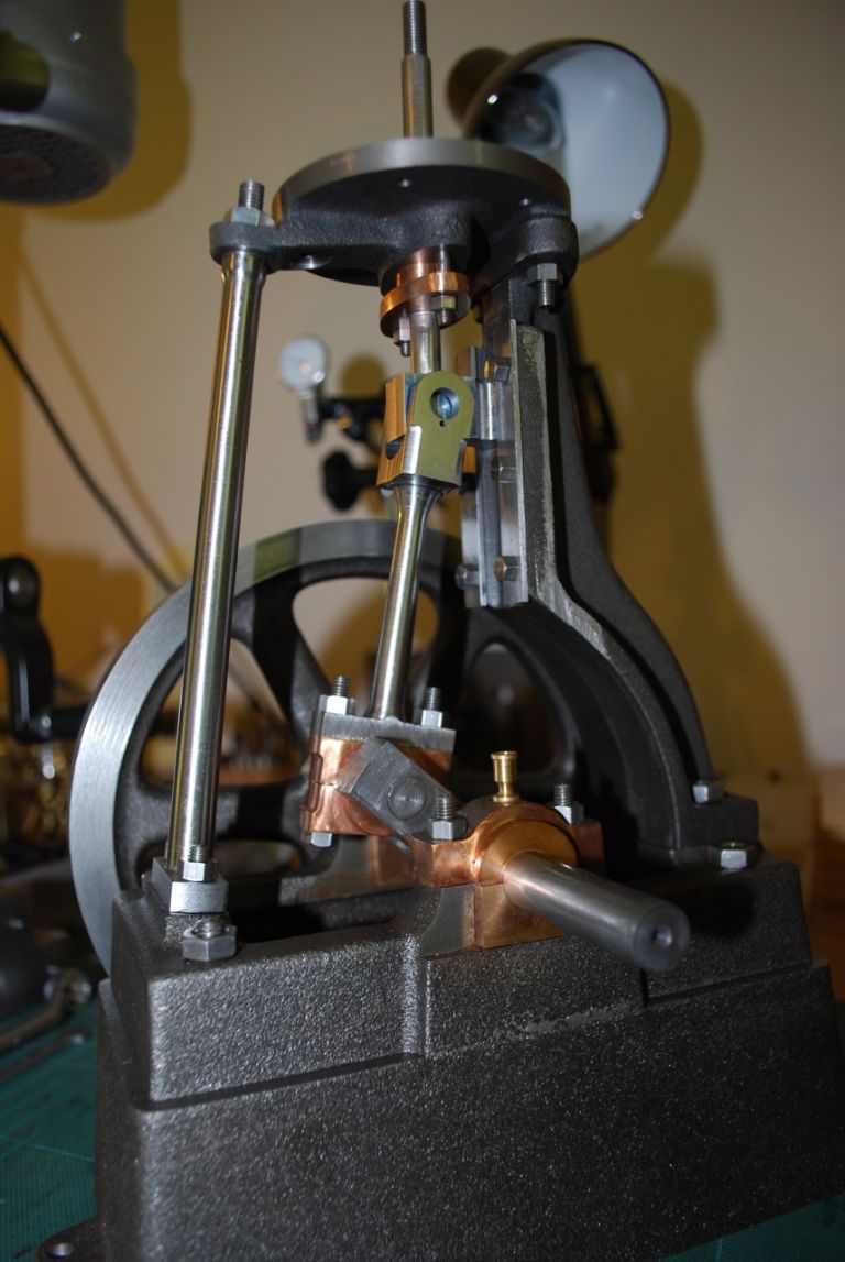

A couple of photos of todays progress.
I have the crosshead fitted now but although its a solid fit and doesn't have any play the best I can manage does have a too big a gap in between the Con Rod fork - it feels like I've learnt an enormous amount from doing and fitting it so I'll leave as it is while I'm ahead I think.
I found it a bit of a crunch time as the Crosshead seems to 'link' many of the vital parts, I found I had managed several errors so far that had to be sorted out before fitting -
1. I had not made the Con Rod Fork deep enough - so a bit more plunge milling needed - that went perfectly.
2. I did not have the Con Rod 'shoulder' in the right place, just a tiny bit out but it was catching on the lowest Guide Plate bolts - bit more plunge milling required but it looks fine I think..
3. Needed just a tiny bit of easing to the Standard Groove.
Had great fun spinning it over once it was done - and it feels very smooth...!
Drilling the oil hole - I put in a small CSK as well...

The finished Crosshead and Piston Rod.

Progress so far..

19/07/2015 13:10:11
Again these photos will likely look the same as yesterday - but I have the grooves in the Crosshead done now and also the Piston Rod made to the right size.. I managed to leave off the 5/8" thread length somehow when I measured to make the first one..

Hopefully I can start going forward again now and may even get to see how its turning over so far in the next day or so..!

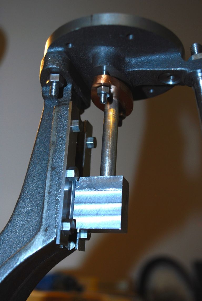

Just a few quickie photos of progress today.. Still with soon to be discarded short Piston Rod..
Starting to Mill the Crosshead.[ Using the 'stop' for quick removal and replacement while trying on the engine..]

I was using the bar from my first attempt - from the other end and upside down, but ended up with the hole showing through, I should have measured beforehand with more care - so to clean up I had to mill to size from the bottom, it won't leave enough metal to do the rather elegant 'upsweep' but I think it will be fine..
Showing the fit around the Guide Plates and the 'under hole' removed - I've not redone the curved half rounds yet but will do next session.. Quite surprising how solid it is in the Standard now, I can't budge it side to slide but slides up and down perfectly..
I've spent a little while on it this morning and it looks like i've done nothing - taken a bit too much off the fork end of the crosshead but as I say there is no movement at all - I needn't have taken so much - I came across Andrew Smiths comments too late, they were along the line of - when assembling the crosshead don't have anything more than finger tight at first, good lesson learned even if a bit late..
and my replacement Stainless bar has just arrived..

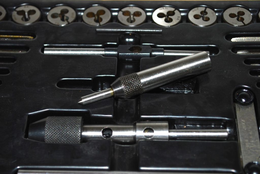

Hi Ian
Thanks, and yes I'll definitely be trying as you say - but also I see I have a little 'centre' type attachment in one of my Tap and Die sets that I've not noticed and can use on the Mill with this method. I'm often a bit limited tapping on my small Mill because of lack of length between the Table and Tool - the Centre attachment is quite a bit shorter than the little 'Pin Vice' type tool that I usually use [not tightened] with a collet. So could be really useful - heck no looking again and with it pushed right up into a collet its going to be much shorter - what a useful little find, thanks again Ian..
I normally use the small 'pin vice' type tool in front of the little centre in the photo for tapping on the Mill.. The Collet should come right down to the knurl on the little centre, thats a big difference..
Makes me wonder what other things I have that I may not have realised or don't know how to use..!
