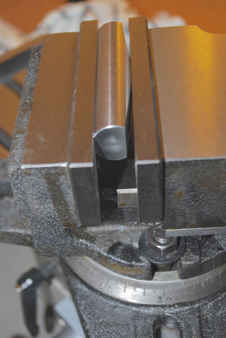

02/05/2015 16:19:40
Time to get back on with the engine. After watching Eric's video's its clear that earlier in the build I didn't square off the bearing blocks properly which I think contributed to the solder failing when tightened in the chuck. They were definitely not square, out by a tiny bit - "that's the best the equipment can do" I remember thinking and I thought they would be ok at the time - hopefully I know better now... So anyways I thought I would make the little 'holding' tool / bar that he was recommending before going about squaring the supplied bar for the column and using his method. Its just a piece of bar with some flats - 2 parallel and two tapering for supporting a part when squaring off..
It didn't take long to do and should get lots of use I hope. I'm sure there are lots of different ways of squaring a part off but this looks like a good idea to me and you have to start somewhere. It doesn't have to be sized exactly but I need the practice... First time I've tried for a nice finish on the new lathe and easily the best I've ever achieved - indexable tip but with the tool angled over to the tailstock CCMT 06/04/02 I think. I can't get them to give any kind of finish if presenting at 90 degrees to the work which seems odd somehow..
Putting the flat down one side of the bar - this side goes against the fixed vice jaw (.the back one)
Didn't have to do this but decided to aim for the tapered flat going to 25% depth of the diameter - so used my little Trig App to get the angle, aiming for the tapers to meet tin the middle and then to put a flat across them. This small flat sits against the part. The 6 degree angle was the one I needed to find. I'm not saying the figures are exact, but for anyone interested in the figures - from my scribbles I can see the bar was 77.22mm long. The two sides at right angles are the known ones.. Diameter 18.57mm.
Putting in the small flat parallel to the long one.
The finished tool / bar.
The tool / bar in the vice jaws. Vertex Vice.
Still working on the assumption of course that its only other beginners who will look at this thread...
Sorry if I've waffled on a bit over such a simple thing..
Hope it was of interest to someone...

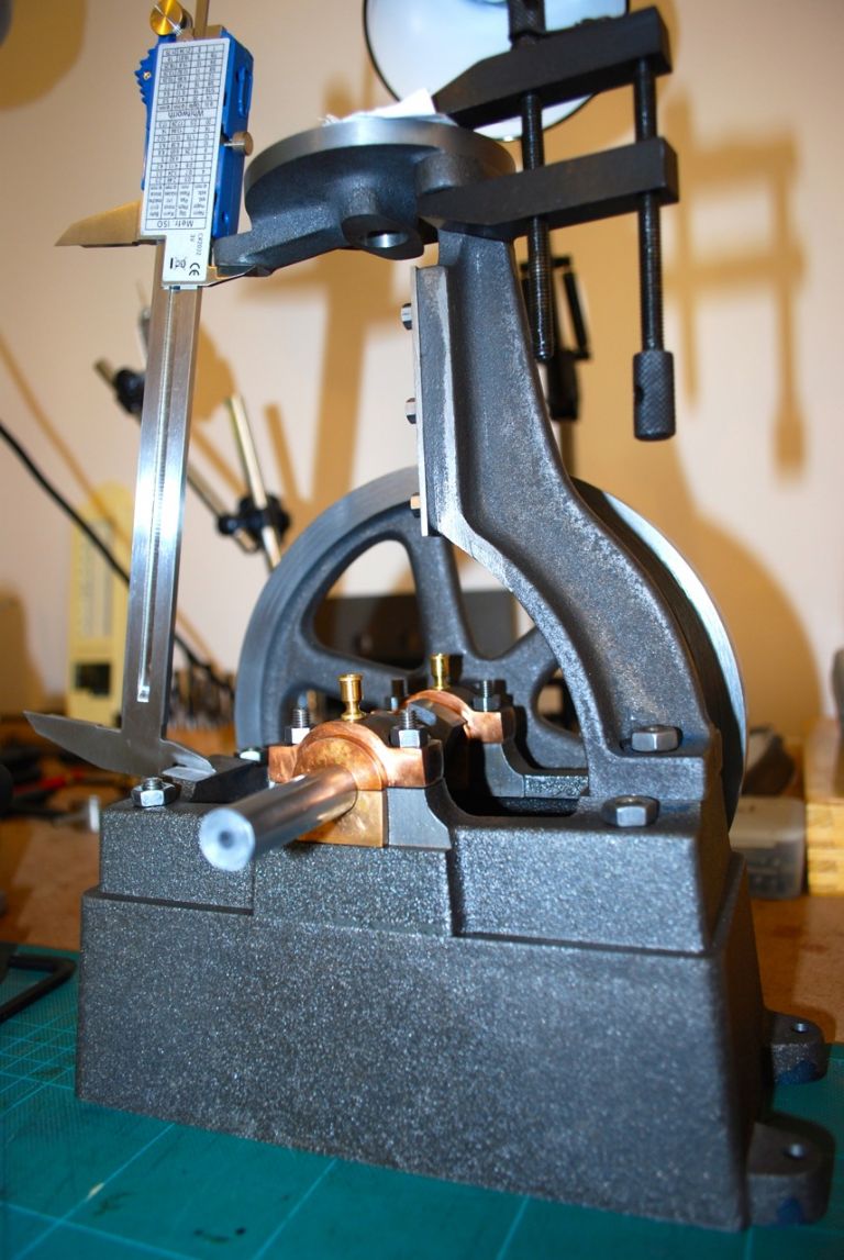

25/04/2015 13:24:44
The Bottom Cylinder Cover in place, nice tight fit on the Standard.. (Nuts not screwed down)
The Support Column nut now with enough room and sitting properly.
Next to do the tapered Column.
Cheers.
Allan.
Camera has been playing up, not focusing, now it seems to have died..!
Edited By Allan. on 25/04/2015 13:44:05

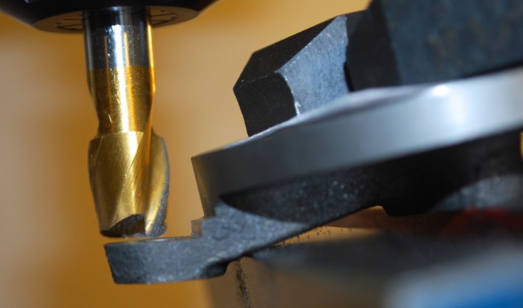

24/04/2015 13:13:00
Thought I may have had trouble getting this hole right, but that went ok - it was facing the top side of the Column Support arm for the Column nut to sit properly that I found difficult. The Assembly Drawing shows a spot facing in the top but I couldn't seem to get the angle for that being so close to the cover rim, so I tried to go with the method used by Andrew Smith in his guidelines on building the engine - but I'm left with an awkward little step to cleanup. I need to get some small files for it..
Showing the difficult angle in facing the top of the Column Support Boss 1.. The Drawing by Andrew Smith.
Showing the step left in facing the top of the Column Support Boss.. The picture makes it look worse than it is but I want to get rid of it if I can..
The Bottom Cylinder Support Cover so far..
Cheers.
Allan.
Edited By Allan. on 24/04/2015 13:13:34

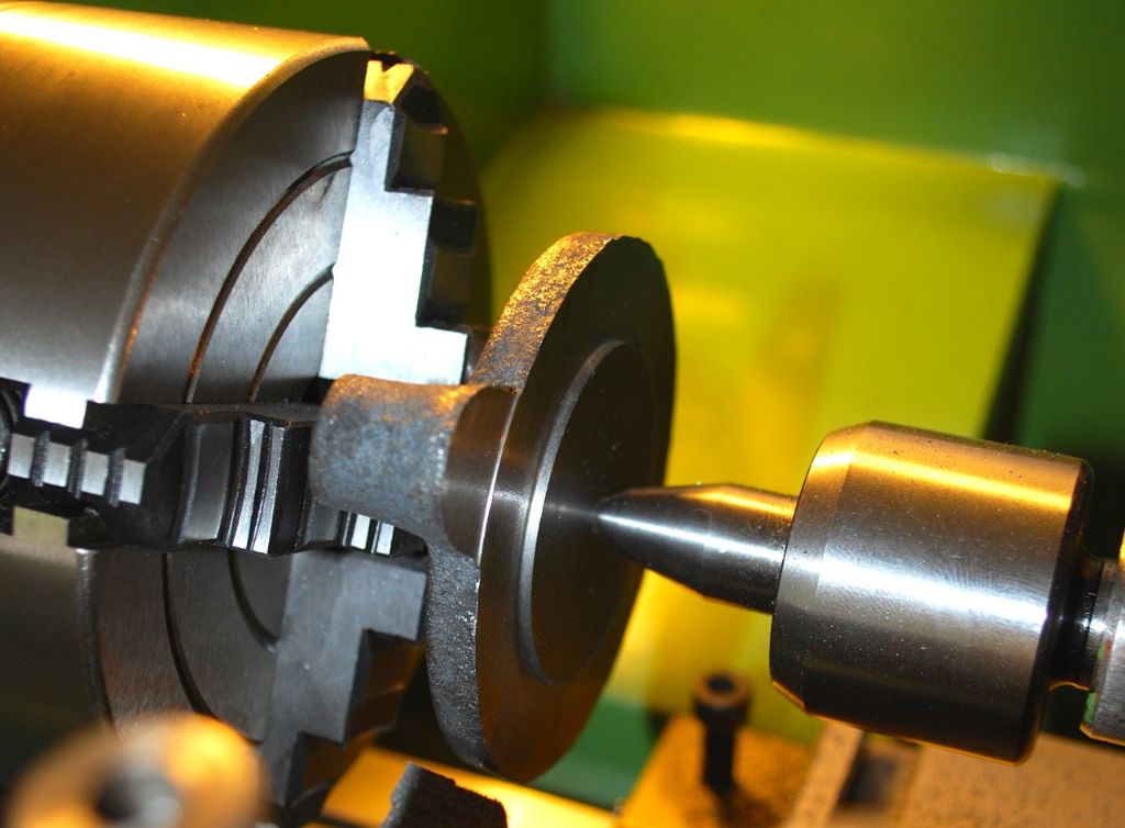

18/04/2015 13:10:05
A little more work done on the Bottom Cylinder Cover.
The turning to size finished.
After drilling - test fitting the supplied 5/16" Stainless Steel bar to make sure it didn't need skimming. The slight score mark is on the 2 7/16" PCD for the fixing holes etc - to aid marking out later
After reversing in the chuck - setting the hole to run true.
After initially turning the chucking spigot and then reversing to hold by it should i have used the 3 jaw? When setting up by holding on the spigot there were no machined surfaces to set to run true with the DTI so I set the outer rim of the casting to run true in the 4 jaw. I can see now that the central hole is slightly out through the spigot as a result I guess. I've set up now to continue after reversing by setting the hole to run true with the 'finger gauge' and it [the hole] looks to spin perfectly, I know the chucking spigot is to be cut away shortly, just wondered if I have gone about it the right way or if it matters? Hope that makes sense.
Thanks for any advice.
Regards
Allan.
Edited By Allan. on 18/04/2015 13:14:12
Edited By Allan. on 18/04/2015 13:14:58
Edited By Allan. on 18/04/2015 13:20:38
