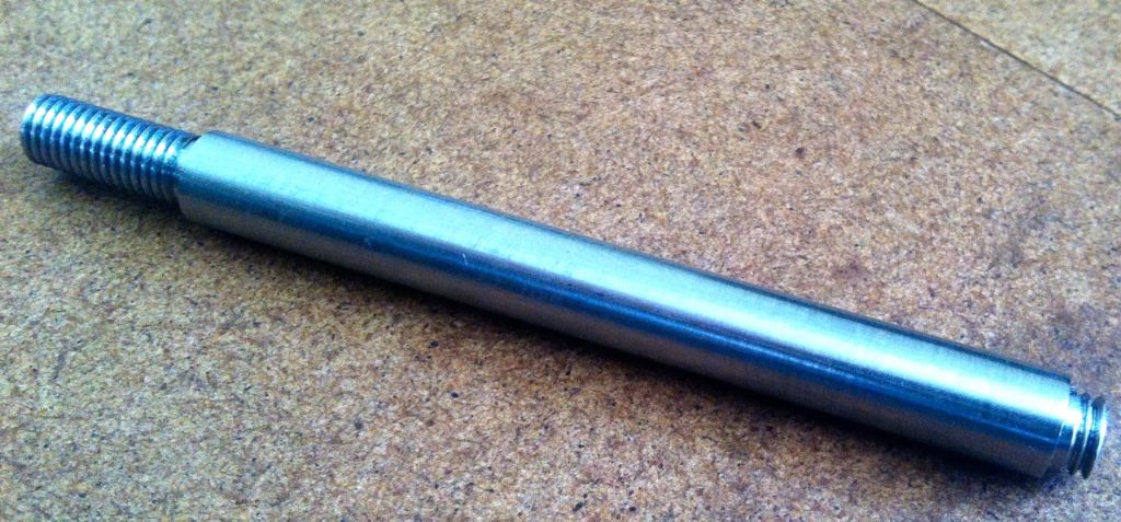

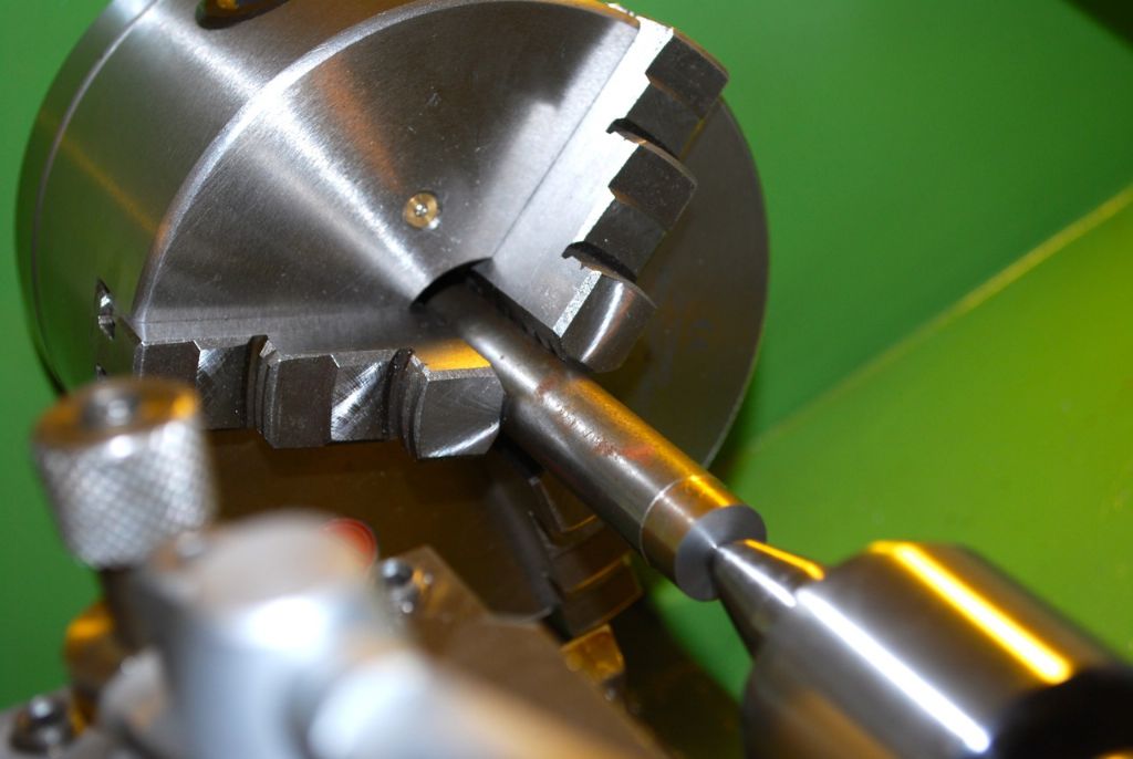

This looked like it had to be the easiest part to make on the whole engine but threading the Stainless Steel by hand with the chuck wasn't easy - finally cut the thread with the die fully open and then another pass tightened up to get a better thread and one that fits a test nut I was using. I did used to have a tailstock die holder but it only took larger size die's - let it go with my old lathe, (stupid as I should have kept it for my next lathe), I'll have to get one that fits more sizes, it would have made this a better and easier job all round if I'd had one i think. I'm hoping to be able to wait before trying screwcutting on the Lathe until I've got one with gears rather than 'change wheels' - but I don't know anything at all about the subject yet..
There are only a few dimensions involved with this and I've double checked that all is right - but I seem to only have two and a half threads at the Crosshead end - have to see how that goes or I'll be having to redo maybe.. Doesn't look right somehow.
Checked again both ends that edges are clean and a nut will connect with the shoulders, but I'lll be able to test properly when the mating parts are done...
The split sleeve worked perfectly and left no marks....
The finished Piston Rod.

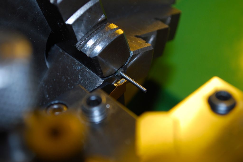

25/06/2015 09:48:02
Ended up with .01mm difference end to end which is brilliant given what I had first time - so didn't need any centre support after all just a lot more oomph and it was much better to hand feed.. With more time spent could have got even closer..
That turned out to be a nice little exercise....
Thanks again..
I would have been better off with a much smaller parting off blade I think.. Really pleased with how the Knife Tool worked.
The Pin was made from Mild Steel..

25/06/2015 08:07:59
Hi Clive and Jason
Thanks - this is the first time I've tried anything this small, I've just gone back to lathe and using a little over 1000rpm and my knife tool that I made - my mike is reading 0.016mm difference end to end and the finish is really nice - not even tried more than one pass at the same setting yet... great, can't thank you both enough. Bit more learning done..!
Garry
25/06/2015 07:40:27
Hi Clive
Yes I was running very slow! I had it slow to slow down the auto feed I think about 250 rpm - I'll try much faster and hand feed and see how that goes, thanks!
Garry

25/06/2015 07:15:57
I've been having a go at the little 1.5mm diameter locking pin and although I've managed to make one that is probably quite useable its not very good as it has a taper due to deflection when turning (no support without a centre in) - its only about 5/16" long and it has a 3 thou taper which is a bit hopeless I guess really.
So I thought to use a travelling steady and do a piece an inch long to part off from thinking I could have the tool immediately behind the steady - which I can but then discovered that on the next pass having wound in the steady to the new smaller diameter the length that you can turn each time gets progressively shorter due to the steady coming up against the new shoulder each time - I can easily make a better job of this short pin now I hope by having the steady further in front and staying up on the larger diameter or even by just having a centre in - but I was wondering if i'm missing something or likely being a bit dull here - if I wanted to use the travelling steady to turn along a long length I can't see how it would work with the turnable length decreasing each time with the steady being wound in each time to maintain contact as the diameters decreased..? If you put the tool in front of the steady then you have the same problem with the shoulder at the tailstock end..?
Sorry its early, maybe that doesn't make much sense - I'll have to do some reading up on using it later...!
But in case someone can understand what I'm trying to say and can put me straight - thanks..
