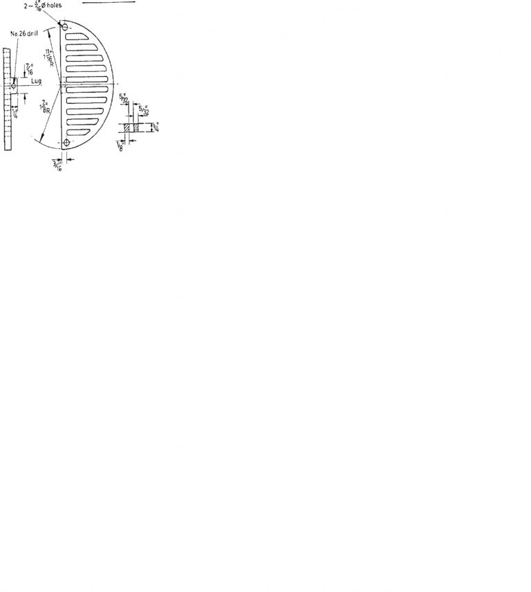

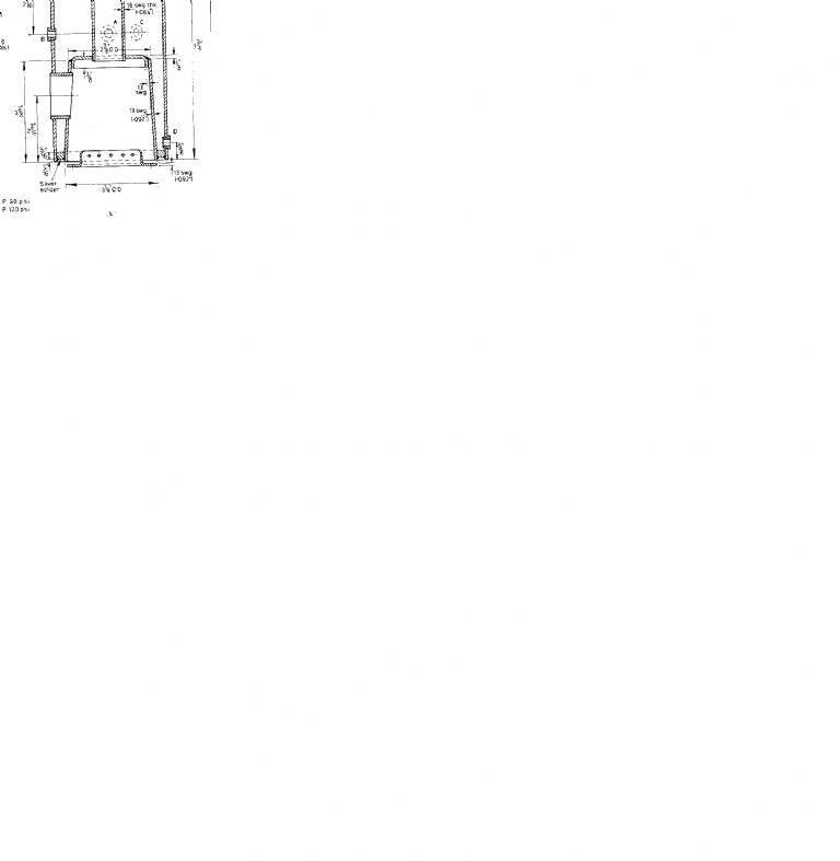

16/12/2020 14:02:55
Posted by JasonB on 16/12/2020 13:59:45:
Quite a few people have had problems getting castings from the only supplier of these that I know so depends who your "chap" is but you may want to search this and other forums for threads about them.
Ok, thanks I will look in to it. I didn't mention the name as not sure about promoting commercial suppliers.
16/12/2020 13:55:50
Posted by JasonB on 16/12/2020 13:25:44:
Looks like it should be about 3" dia or a little less so it does not get stuck in there.
Are you going to risk buying a set of castings or fabricate?
Hi, I was going to buy a set fo castings from a chap in the midlands. What is the risk in using castings? It would be far easier for someone of my limited experience to use castings. I was thinking of lifting the foundation ring and drain plug by 3/8" and shortening the firebox pro rata to accomodate the grate.
Many thanks for your reply,
Nick.
16/12/2020 13:01:06
Hi, I am about to pull the trigger on the 2 inch scale Dairy Engine but before I d I need a little advice. According to the drawings it would be impossible to fit the grate, which is 3 3/4 inches in diameter, into a space only 3 5/32 diameter. the written notes say the grate sits on top of the boiler feet but I cannot see how. If anyone has built one of these little engines, some guidance would be well received, or in fact any advice at all would be most helpful. I have attached the relevant parts of the drawing...dairy engine 2.jpgdairy engine.jpg
Edited By Nick Clarke 2 on 16/12/2020 13:02:26
