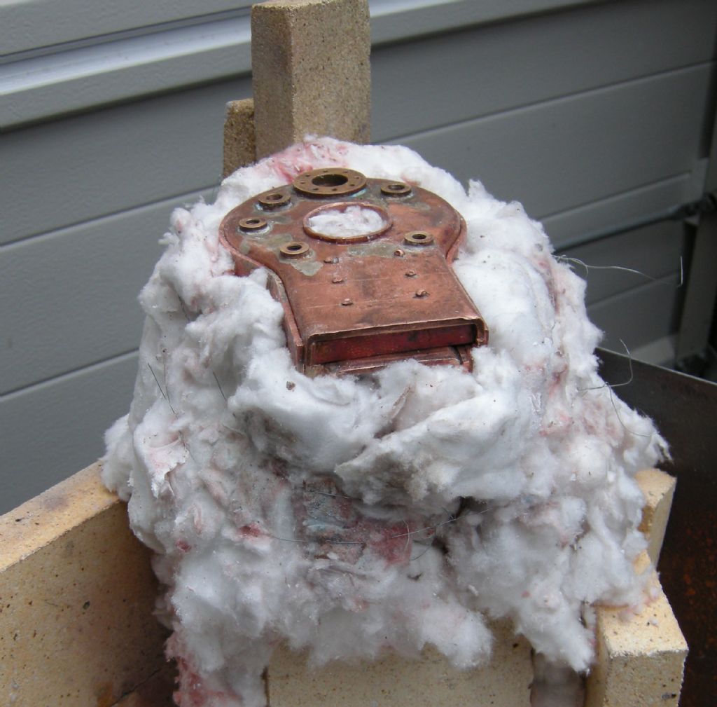

boiler insulated ready for back-plate soldering
In order to get such a large plate and fixings up to solder flash temperature it is necessary to completely insulate the remainder of the boiler - even then it needs serious heat input.
