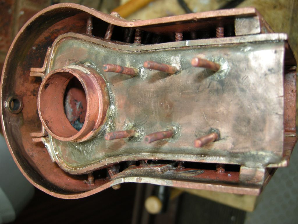

Firebox back plate
The firebox ring and the 6 copper stays were pre-soldered with a high temperature solder before the whole plate was soldered. Just one holding screw was used into the crown. The bronze threaded stays are visible
