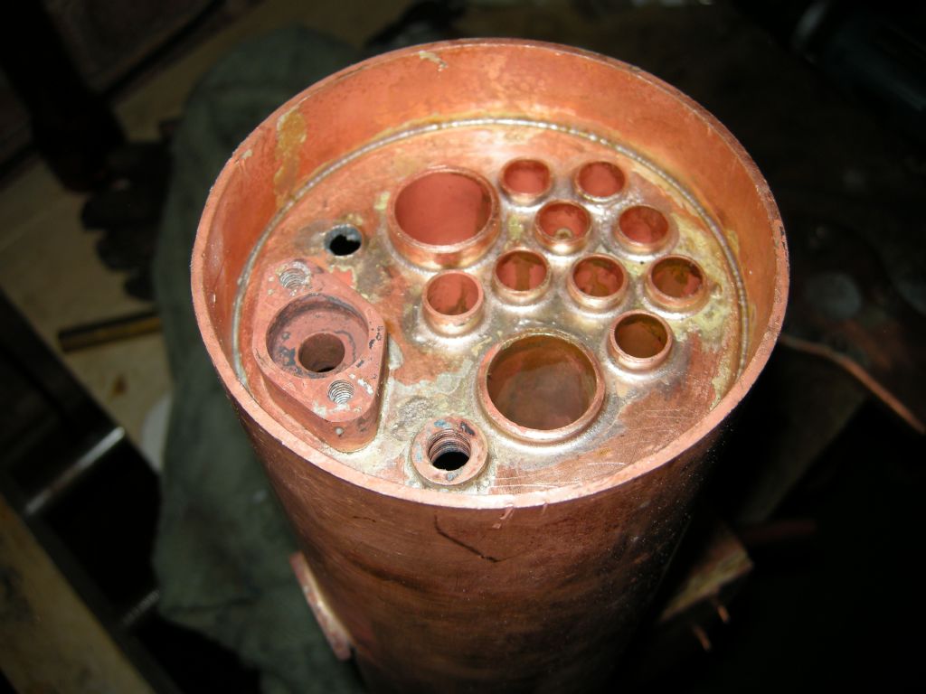

Smokebox tube plate
now fully soldered. it took a lot of heat to get a decent flow of solder, the trick is to pack the fire box with insulation so the heat doesn't go 'down the tubes'!
