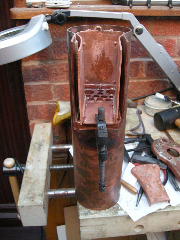

Setting the firebox assembly in position
once the tubes are soldered into the firebox tube-plate the inner section of the boiler has to be tried in position with the smokebox tube plate to get correct tube gradient
