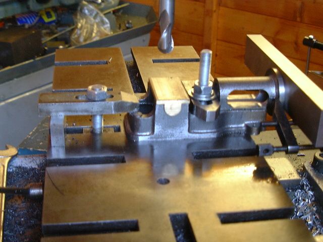

Machining the bearing seatings on the 10H soleplate.
After nibbling away with the ball nose, the bearings fitted nicely. I machined the sides and the bottom so that a piece of thin paper would go between the bearing and the casting. This was to allow for paint and the bearing does not need to be a totally tight fit. The bolts and crankshaft will hold them in line.
