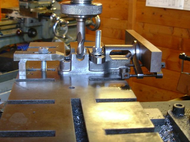

Machining the bearing seatings on the 10H soleplate.
After machining the top of the bearing mounting surfaces to size, I started work with a 7/16in. ball nose cutter to machine the radiused slot. I probably cleaned the sides out first with an end mill.
