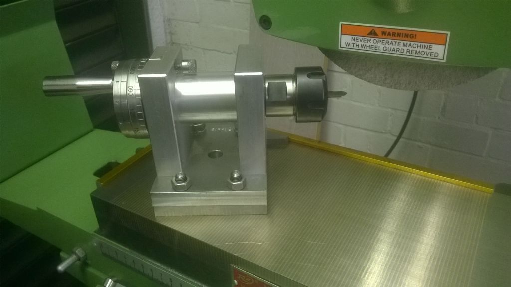

Angle grinding setup
Photo showing the setup I propose for grinding the cutting angle of my engraving bits for the David Dowling engraver which I have recently purchased. When used in this configuration, I will replace the grit grinding wheel with a resin-bonded diamond deep cup wheel. This photo demonstrates the indexer setup only.
