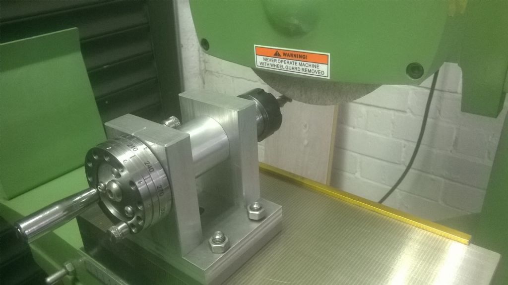

Cylindrical grinding setup
This is a posed photograph showing the proposed setup for manually rotating a workpiece so as to prvide a simple cylindrical grinding arrangement on the surface grinder. In order to mount the fixture on the grinder, I made up a steel plate attached to the base so as to utilise the magnetic chuck.
