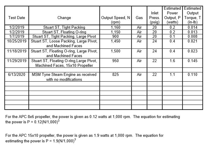

Oscillators Test Results
Uploaded by Turbine Guy on 13/06/2020 18:07:22
