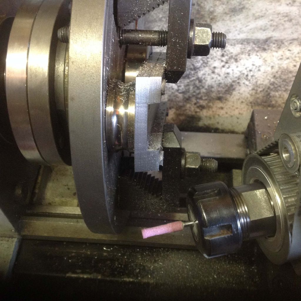

Tool slide end ground
The finish of the bevel wasn't as good as I hoped after using the side of an end mill, so I used a Dremel grindstone to achieve the finish shown above. Just need to engrave the fiducial lines and that's the tool slide completed.
