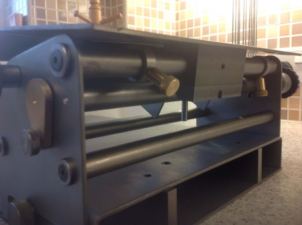

The traverse pin disengaged
Seen from below, the traverse pin can be seen hanging straight down, out of engagement with the sliding block. I have replaced the plastic tube for the traverse mechanism with a steel tube of 2mm wall thickness for ease of construction and to provide a more substantial arrangement.
