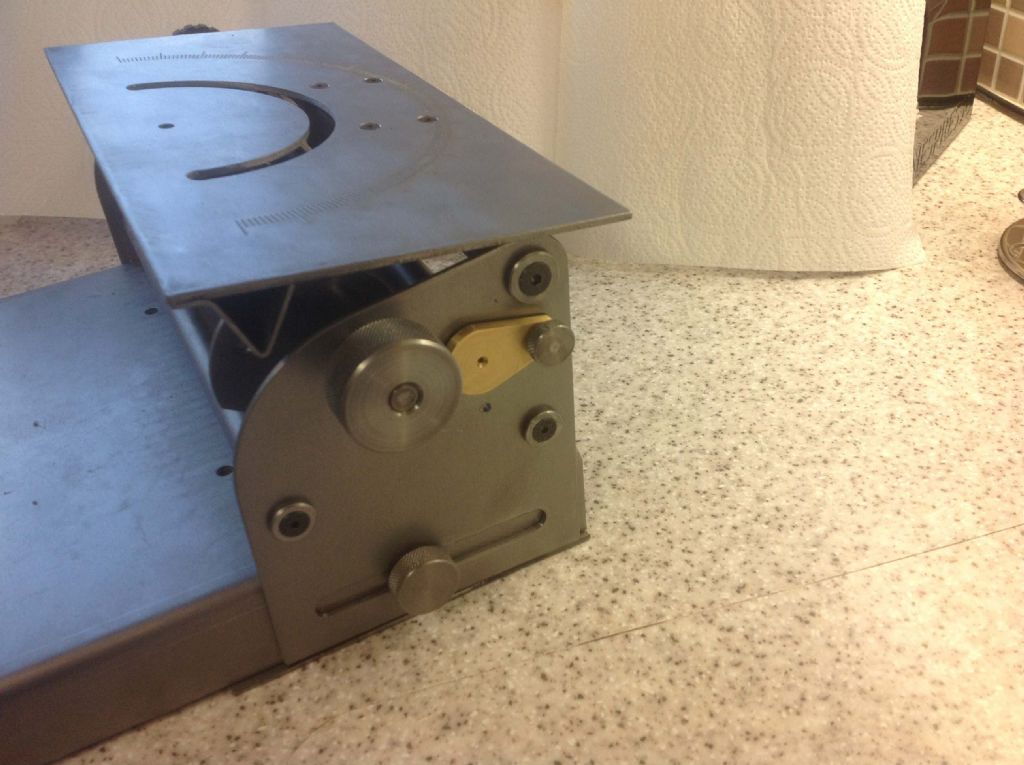

The lefthand side
Not one to "leave well alone", I have incorporated a few 'improvements' of my own into the design. Firstly, the traverse engage/disengage pin is moved with the brass lever shown here and locked in its required position with the screw.
