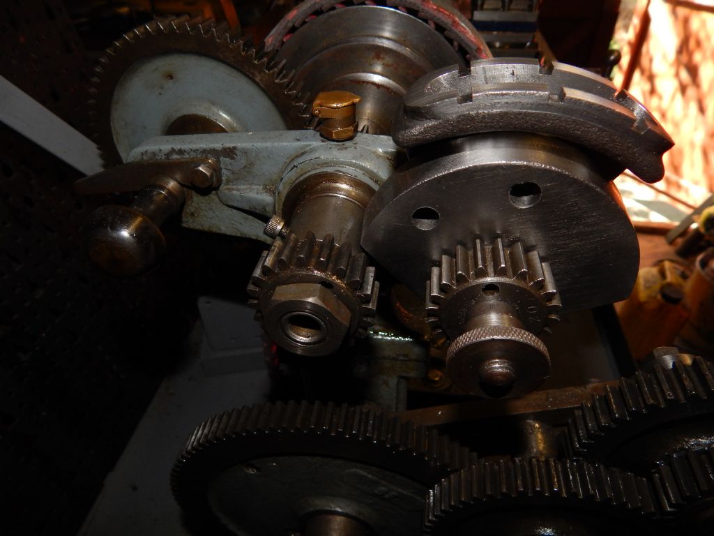

First Try on lathe to check offests
First try showed I need to gain or lose 1/4" from the reverse tumbler or gear on main shaft respectively.. The tumbler fitted in the space well. I had to prop the inside quadrant on the main spacer to photograph. Next I am hoping to turn and place the shaft in for second largest gear.
