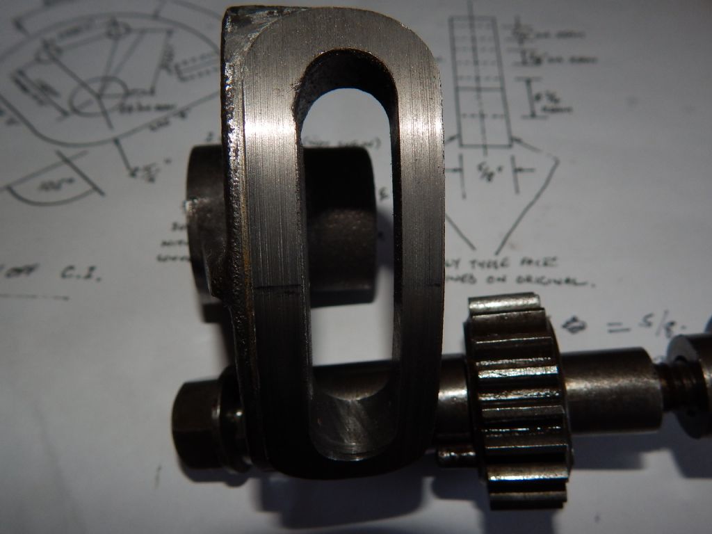

corners taken off
I used a pound coin to mark the corners of the other sections that needed to be removed. The majority of this material was removed with an angle grinder and then was filed to get the final finish. Go easy with the grinder.
