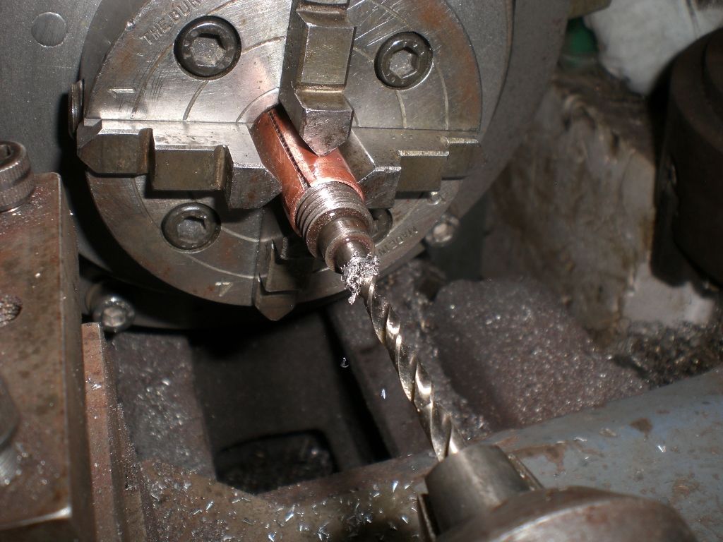

This shows the adjusting screw set up in the four jaw on the special backplate, note the piece of split 15mm copper pipe used to protect the screw thread from damage. After the end was faced off, it was spotted and drilled 4mm to a depth of 20mm
