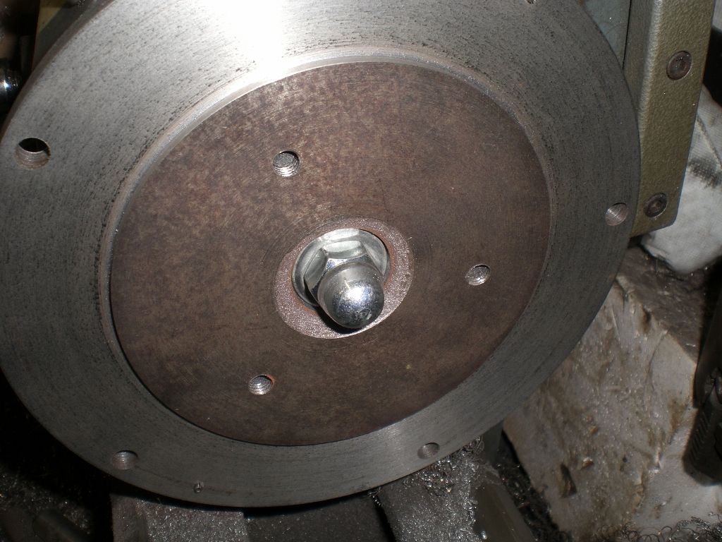

A dome nut is made to fit the steel slice of the backplate, for the end of the adjusting screw to butt up against, so as to resist any pushing through of the adjusting screw during machining
