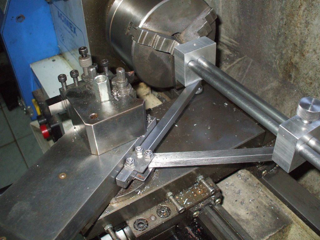

Transferring the angle to the compound.
Turn the gauge 90° and set the compound to the required angle. The majority of the spindle machining is complete - save for the thread and collet bore. Next step - the thread.I'll be trying the toolpost spindle MK.1 with a small rotary grinding wheel to get a good finish to the bore - I hope.
