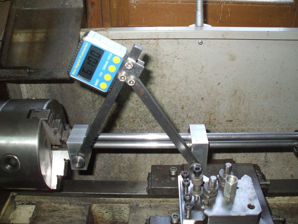

Preparations for setting the compound.
Prior to cutting the 32 x 1.5mm nose thread, I'm setting up the compound slide to 29° - stage one, using my angle-setting gauge.
