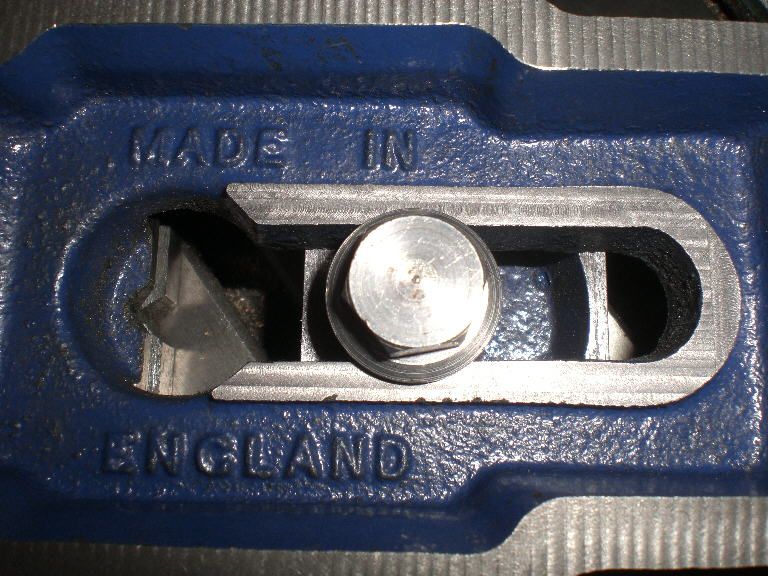

The distance piece with the flange that secures the moving jaw to the bed shows that the flange part does not cover the under side of the slot by very much. I'll most likely make a new one.
