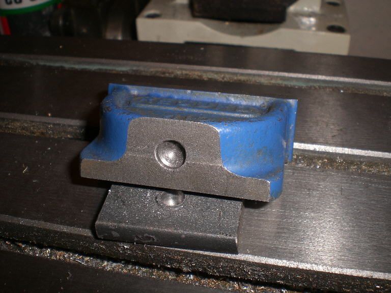

The back end of the moving jaw had also been milled off and a shallow drilling was made to accept the tightening screw, eccept that it is to low and lifts the jaw up when engaged. I've yet to decide what to do here.
