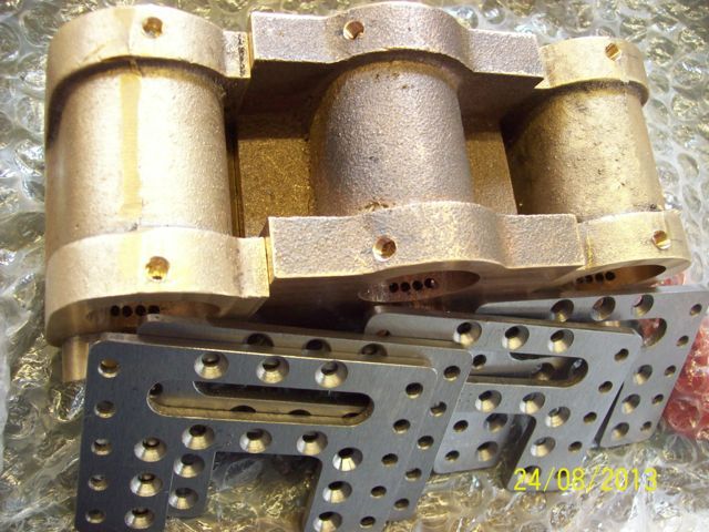

Drain holes
After drilling and tapping all bolting plate holes, and c'sinking the plates, the cylinder drain holes were drilled and tapped VERY CAREFULLY as there is only 1/4" thickness to take the thread and 1/16" bore connecting hole.
