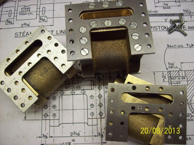

Fitting the plates
Each plate is lined up to the casting reference edge, then spotted through, followed by tapping drill size. Plates are only c'sunk after having been spotted through.
