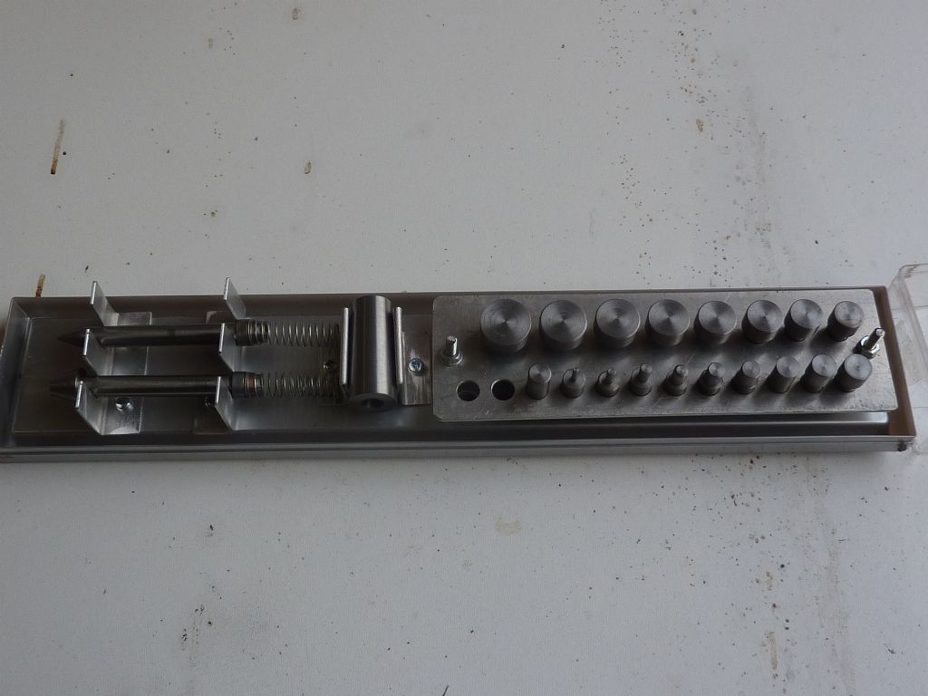

Rotary wheel centre-finding buttons. The taper fits into the bore of the rotary table. A button is then selected which matches the diameter of a centre-hole in a workpiece. The button is fitted to the taper and the workpiece fitted over the button, thus automatically centring it on the rotary table. Much quicker than clocking the workpiece central.
