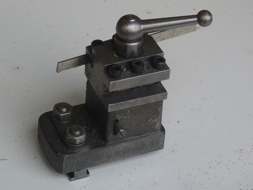

Rear tool post from Hemingway kit. Needs a parting off tool with a much deeper section or much less overhang. The angle of the parting tool means that centre-height can only be achieved with the tool in the position shown, which results in un-usable amounts of chatter.
