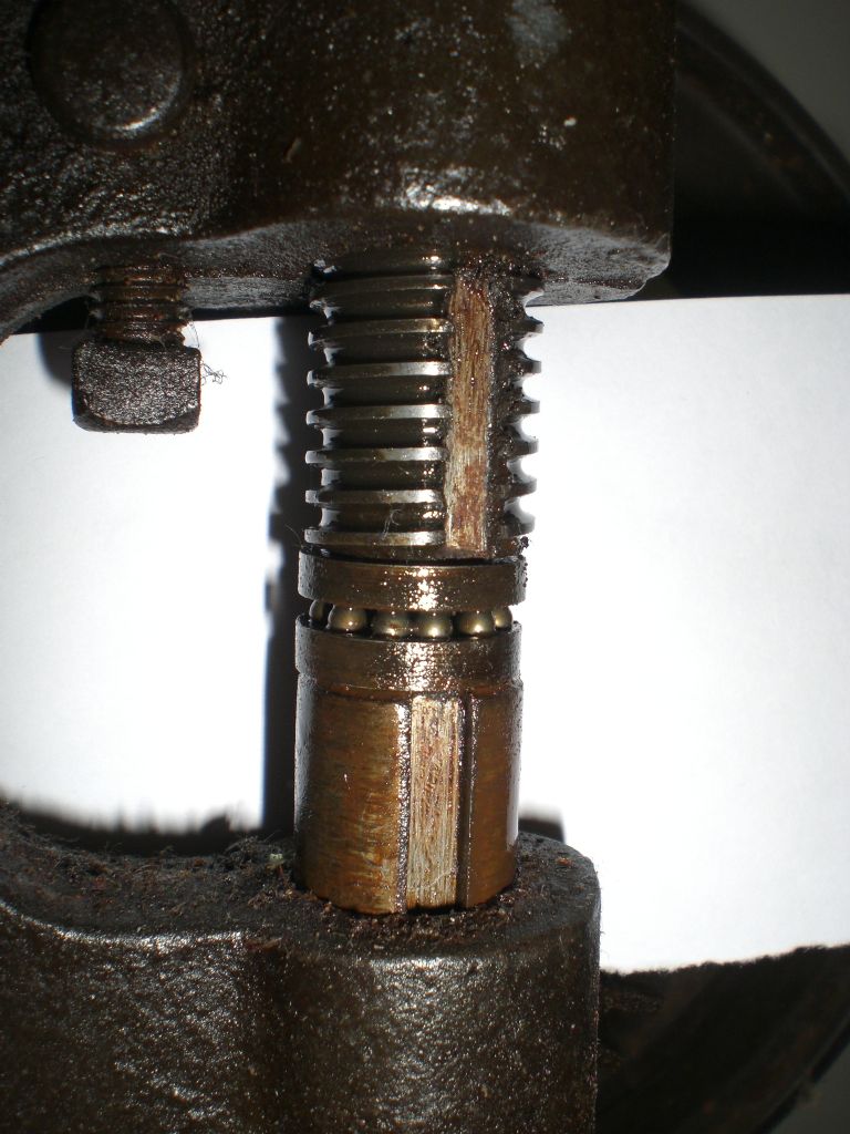

Feed Screw, Bearing and Spindle 2
The thrust bearing is between the spindle and feed screw, the feed srew is hollow and the spindle's reduced portion goes up through it and the feed handle at the top. The keyway in the spindle is key into the bevel gear below
