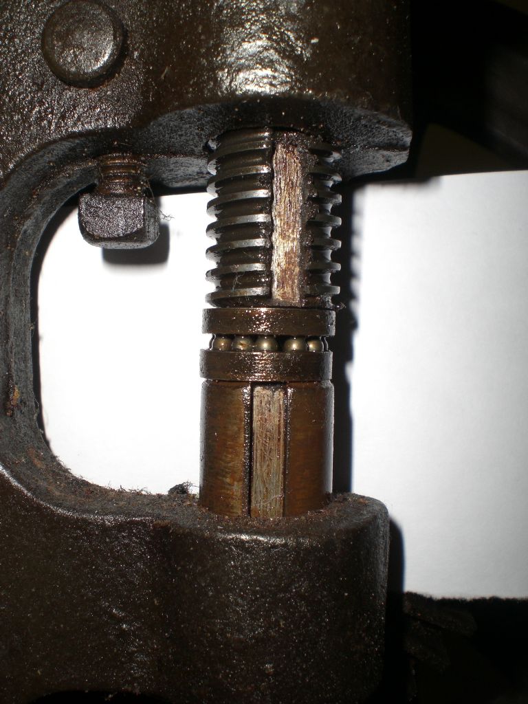

Feed Screw, Bearing and Spindle 1
The feed screw is threaded through the top of the frame and the keyway is keyed to the ratchet immediatly above the threaded portion of the frame
