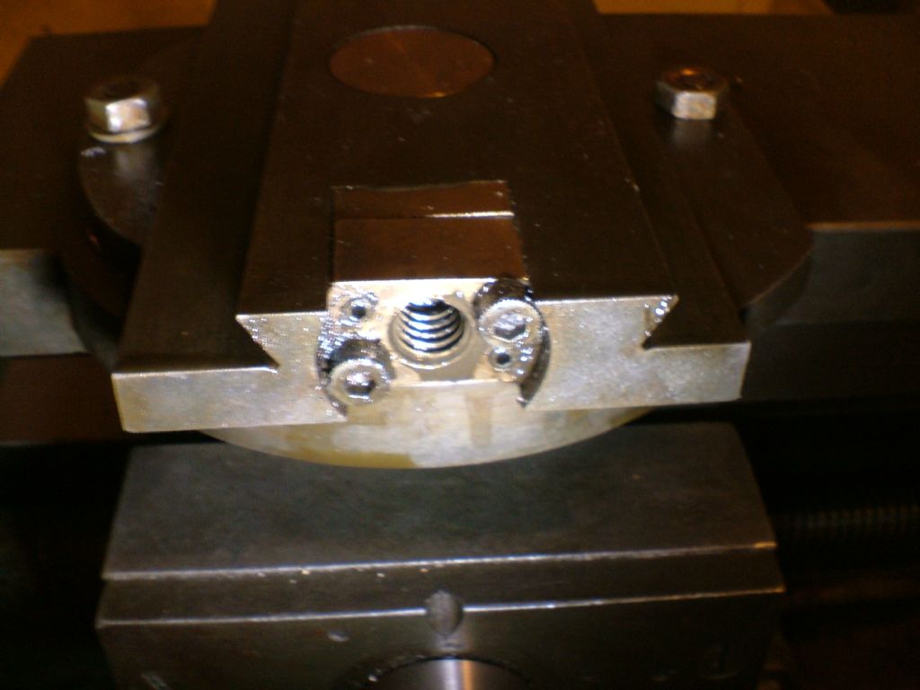

Pultra zero backlash nut. Front view
The grubscrews at 10 and 4 o'clock go through only the front nut. The allen screws at 2 and 8 o'clock pass through both nuts into the body of the cross slide base.
