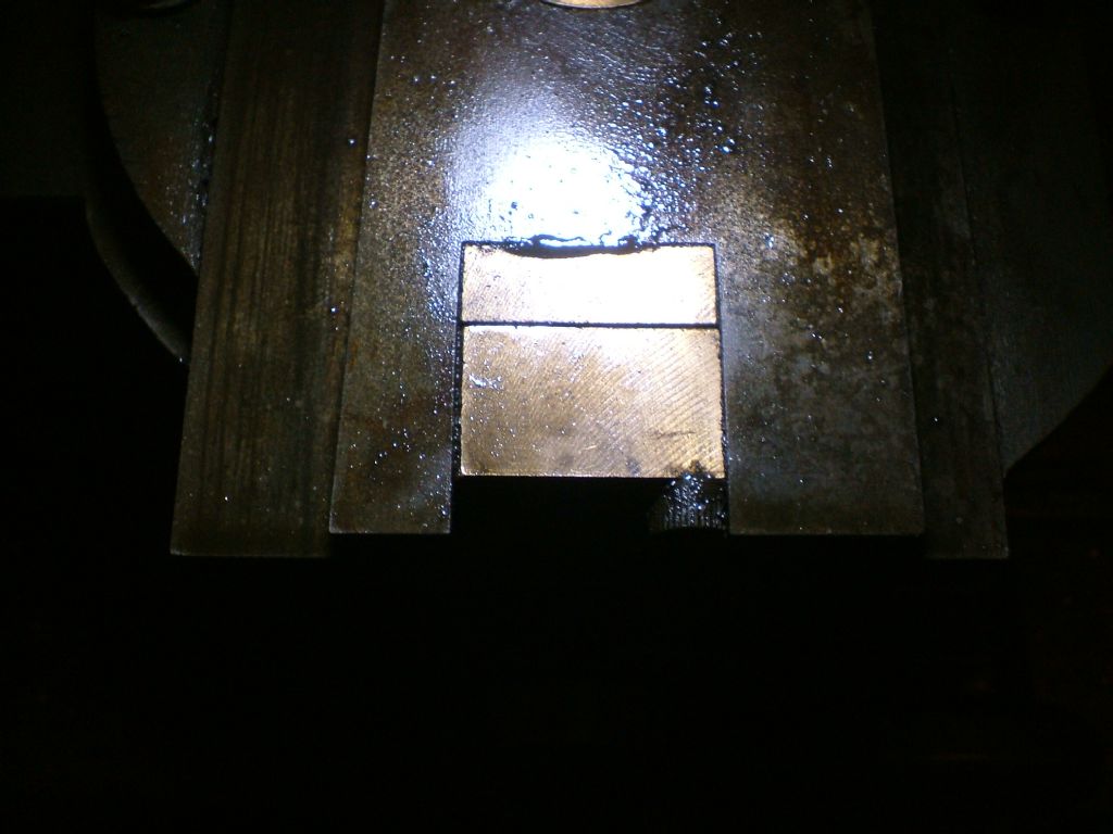

pultra zero backlash nut. Top view
The nut/s plug into a square socket in the cross slide which provides support for only one direction of travel. The allen bolts provide the opposite direction, hence a much larger nut. You can see where the tapered gib strip goes on the left hand dovetail. Only the male part is tapered, the female section is a standard dovetail.
