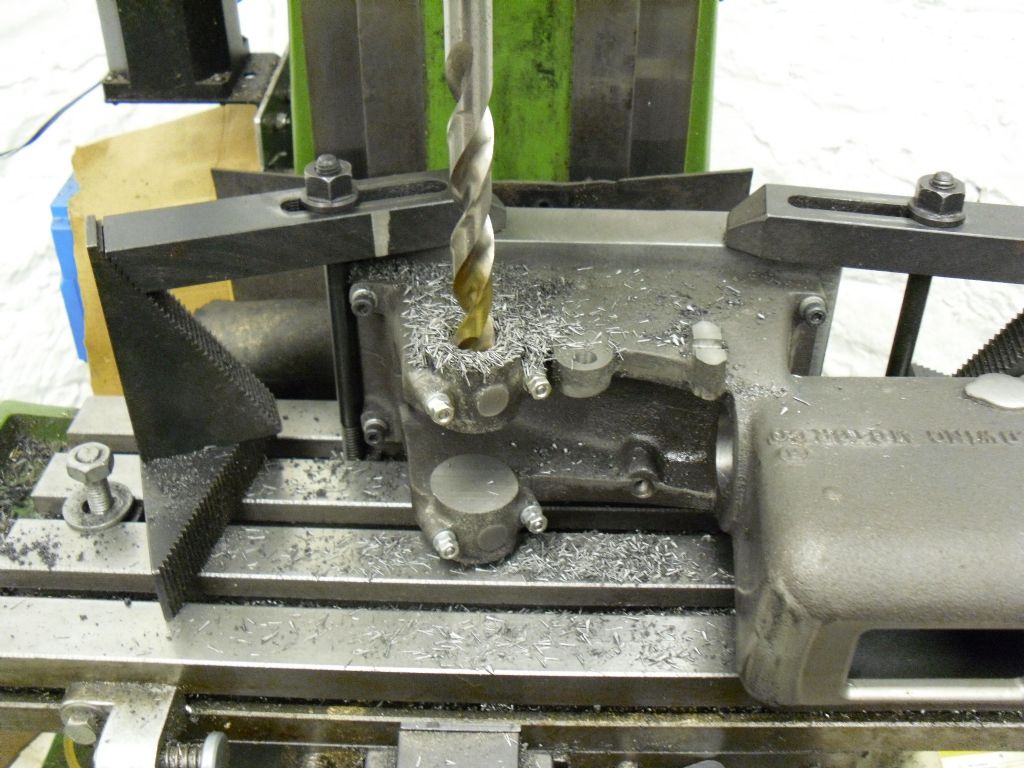

Main bearings.
Drilling the bearings first, then opened up using a boring head, and finished with a reamer. Great care is needed when setting up to ensure the bearings are square to the cylinder bore.
