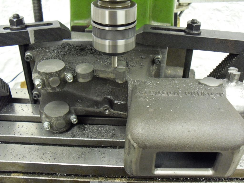

Mounting.
For most of the machining operations the engine remained bolted to the fully machined steel mounting block that was used on the lathe when boring the cylinder.
