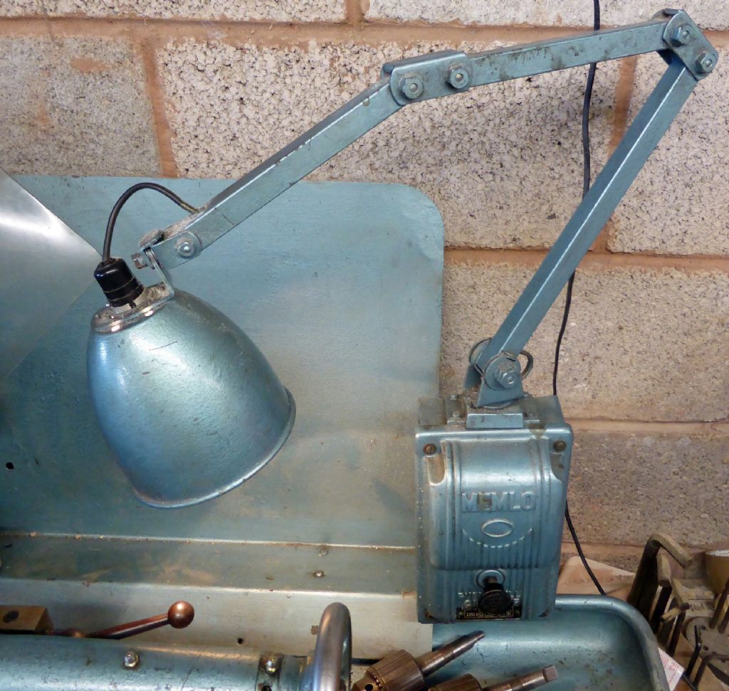

Photograph 1 shows a low voltage incandescent light fitted to an 'industrial cabinet’ Myford Super 7 made in the 1950’s. The blue MEMLO unit is a cast iron box containing a pull switch and step down transformer to 24 or 12 volts and attached adjustable lighting arm. The bulb is unprotected from swarf or coolant and has a very primitive reflector. Mine gives a very yellow-orange light but has a very long bulb life. I have found it useful because the adjustable arm allows the light source to be positioned very close to the work. Both 240V single phase and 440V 3phase versions of these MEMLO machine lights often turn up in workshop clearances and attached to old machine tools. They work and seem pretty bomb proof but there are more modern solutions that use less power and give a whiter light.

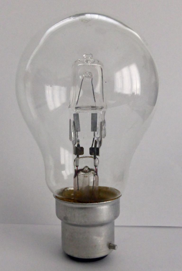

Halogen bulbs still contain a tungsten filament in a ‘glass envelope’, photo 2. They are able to operate at higher colour temperatures by increasing the gas pressure, which raises the filament melting point and the introduction of a halogen, like iodine or bromine, to react with tungsten metal vapour and redeposit tungsten back onto the filament. The outer glass package is usually ‘quartz’ and gives rise to the name ‘Quartz Halogen Bulb’. The colour temperature can be higher than the incandescent lamp and the bulb size is very much reduced for a given wattage. Sadly halogen bulbs are not a lot more energy efficient than the standard incandescent and they run extremely hot. Typically they give perhaps 29 watts energy input for our 450 lumens light output. Incandescent/halogen bulbs of 3200K can have a CRI close to 100.

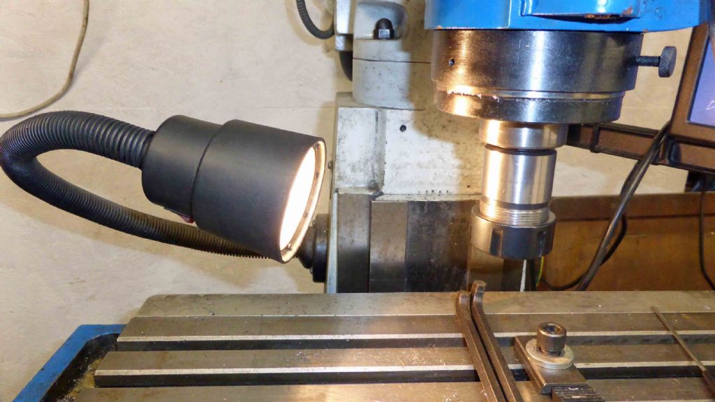

My Chester 6”x26” vertical mill, around 10 years old, was supplied with a with a low voltage halogen spotlight photo 3. The light from this machine light is yellowish but at least the bulb is protected from flying hot metal behind a glass sheet and it can be positioned close to the work with the goose neck support arm. I find I have to remove the protective glass shield and give it a good clean, as oil seems to burn onto the hot glass. A work light like this is very desirable I find and if the mill didn’t have one I would have added a more sophisticated Quartz Halogen spotlight or LED light.

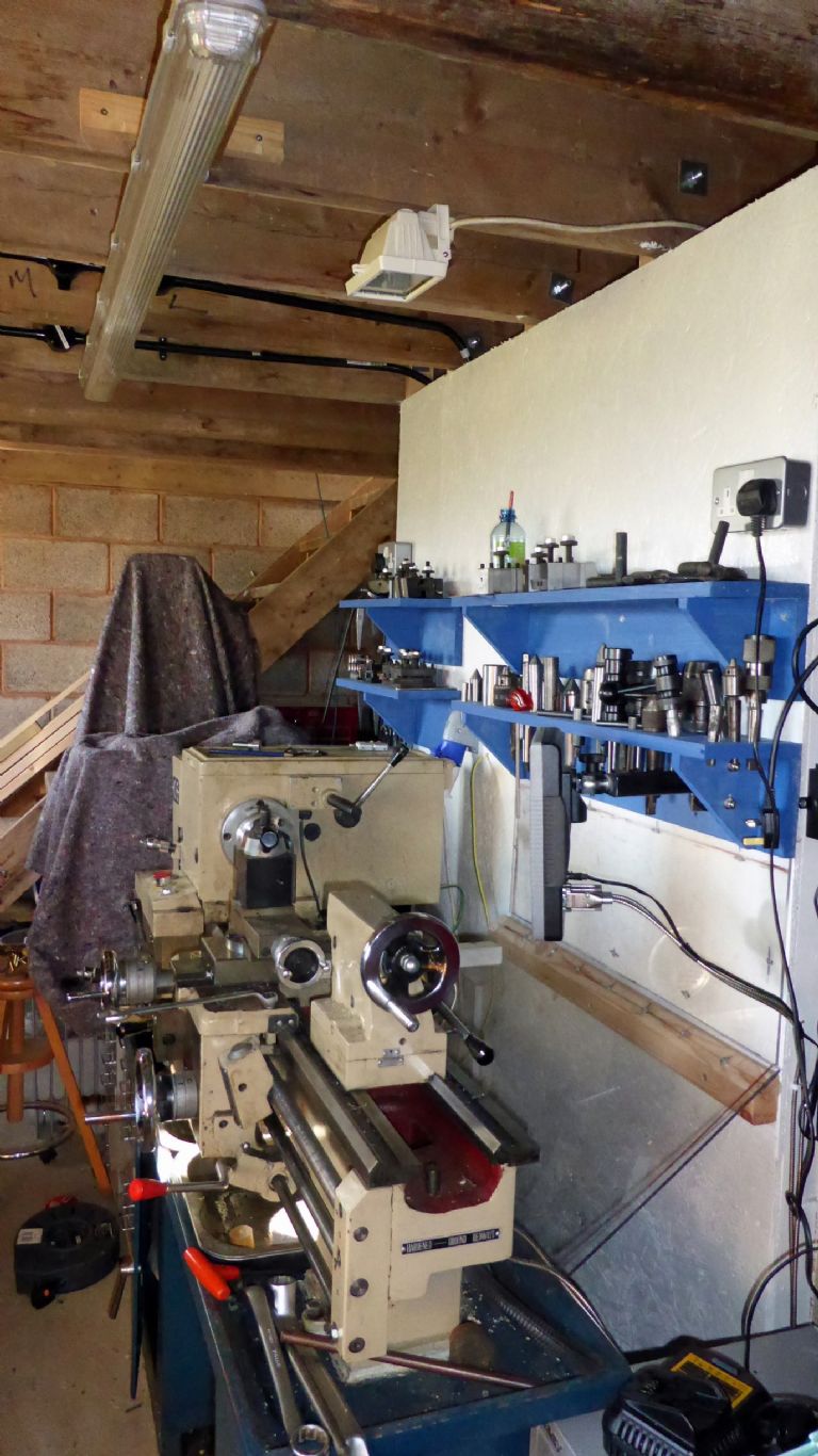

I have, for some years, used ceiling mounted Halogen floodlights (security lights) over several of my machines. On moving workshop, I again installed some 140Watt weatherproof IP 54 units at ceiling height above one of my lathes, photo 4. Although I have a fluorescent strip light close by, the security light makes a real difference and it is safer because of the IP 54 level of protection.
Whilst not being very energy efficient, these security floodlights do give a comparatively white light and the downward reflected heat is a definite bonus in a cold workshop. I find glare isn’t a problem provided the light is mounted above head height. Notice that I have painted the wall behind the lathe white, this helps a lot with the general lighting. These security lights are very cheap units, especially when bought without security features like motion detectors and timed shut down. The units I have use R7S end caps and are rated at 2550 Lumens and 3000K. These units are dimmable but why would you want to? Recommended, if you overlook the electrical input requirements and most designs are IP rated. I.e. enclosed and splash proof.
You may have noticed that ‘Eco Halogen’ bulbs are now being offered and appear to be halogen bulbs built into a traditional glass envelope (photo 2) with conventional bayonet or screw bases. These units offer slightly superior energy efficiency, using 30% less than an incandescent filament bulb and are Energy rated C under EU regulations. It appears that the outer glass envelope has been coated with a heat reflective coating and the gas inside is Xenon. If you are still using incandescent bulbs in your workshop these Eco Halogen bulbs could be a valuable improvement at reasonable cost and modestly lower energy input.

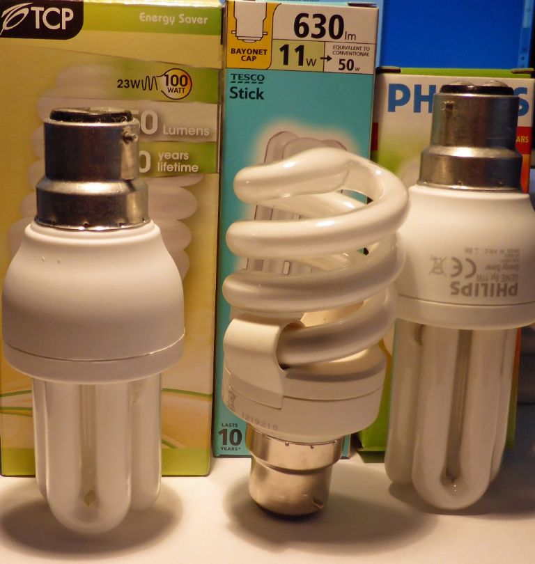

These are a miniaturised version of the office overhead fluorescent strip light. Roughly 9 watts input will produce 450 lumens and the light colour can be tailored by manipulation of the phosphor coating inside the glass envelope. Photograph 5 shows the type of bulb which most will immediately recognise as the ‘energy efficient light bulb’. These are available as screw in or push and twist replacements for the old incandescent light bulb. They save energy, last a long time (over 10,000 hours but this is shortened by repeated on/off operation).
5
Despite all their energy saving performance CFLs annoy many users because they don’t achieve full brightness for some seconds; this is especially true in a cold workshop and some designs seem worse than others in this respect. These CFL bulbs contain electronic ballasts, which is one reason why they cost more than filament bulbs.
Millions of these CFLs were distributed ‘free’ in the UK by Electricity Supply Companies in preparation to the switch over to low energy lights a few years ago. By shopping around one can find 5000K+ CFLs and these give a good white daylight colour temperature and quite acceptable CRI. These are definitely worth searching for, in my opinion. I try to avoid those offering ‘warm soft white’ 2700K bulbs. Some manufacturers use all sorts of names to avoid quoting degrees Kelvin. Colour rendering of about 80% seems common.
Normally a 23-watt CFL is quoted as 100-watt equivalent. CFLs show a huge energy saving over filament bulbs, though some users maintain that the Industry exaggerates the quoted wattage equivalent compared to a filament bulb.
Some CFLs can be dimmed, most not, so read the box before purchase. A typical CFL box will have a panel of symbols similar to this that tell you most of what you need to know. Notice that CRI is missing from this particular one. See photo 6 for the general label and photo 7 for the efficiency label.

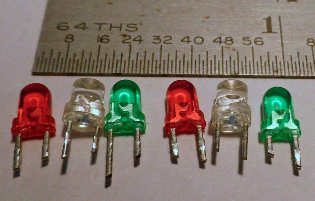

Light emitting diodes have been around for years as very low power indicators in electronic equipment. Photograph 8 shows a selection of these indicators.
8
These are fairly old examples. The actual diode, a junction between two semiconductor alloys isn’t visible in this photograph, just its support framework inside the moulded lens. The colours shown here are the plastic protective encapsulations. Early LEDs only gave a red light but gradual development has added more colours by changing the alloys. The requirement for UV emitting LEDs for Blue Ray DVD players finally completed the colour range. Having UV emitters allowed the use of phosphors to give wide spectral range ‘Super Bright’ LEDs.

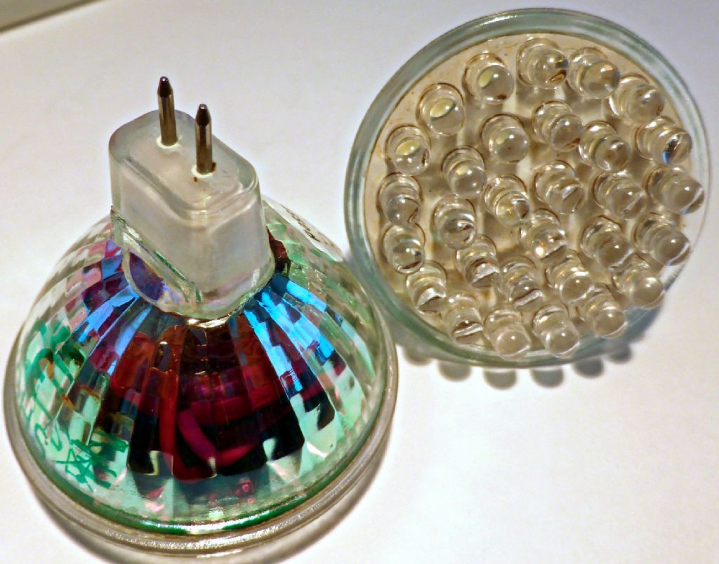

Photograph 9 shows a fairly recent MR16 LED downlight (spotlight) which is rated at 12volt AC/DC 1.8 watt that claims the performance of a 30 watt halogen. As you can see it’s constructed with 30 individual LEDs mounted in a glass reflective envelope. It has colour temperatures of ‘day white 6000-6500K or ‘warm white’ 3200-3500K. Plugging this into an existing circuit produced a brief flash of light then it extinguished! The existing transformer produced too high a voltage at the new lower current and the internal circuits shut the bulb down. Clearly specialised LED drivers are required.

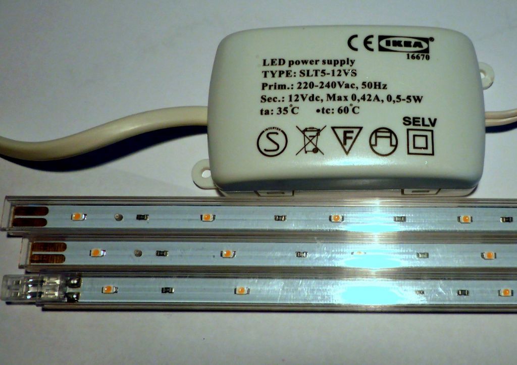

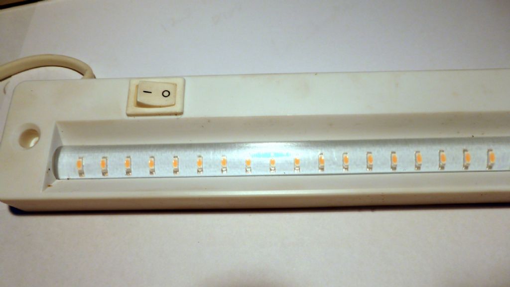

Photograph 10 shows a LED light strip and its power supply (driver) sold to provide lighting in display cabinets. The strip can be extended by plugging units together. These are examples from the IKEA Ledberg range.
The small yellow items are surface mounted LEDs and the even smaller black dots the resistors. The driver is ‘intelligent’ and can handle different numbers of strips, each being about 0.6 watts from 7 LED’s. Should you have a model display cabinet these strips could be ideal lighting.

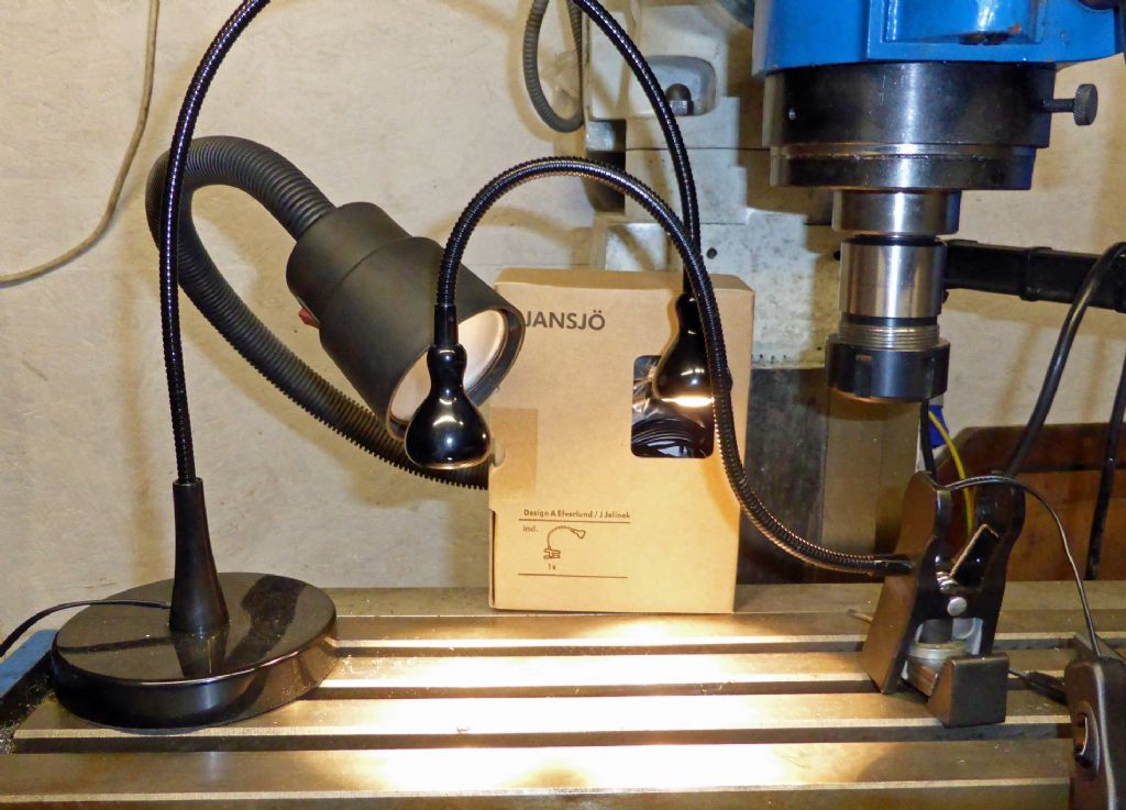

Photograph 12 shows 2 different versions of IKEA Jansjo 3 watt LED desk lamps. Where do IKEA get these names from? These lamps have proved useful in my workshop on the drilling machine and for marking out work. Like all the IKEA LED lamps I have seen they are ‘warm white’ 2700 K. IKEA quote a very long life and the LEDs are not designed to be replaced.
A friend who operates a small lathe and a mill in a garage with no mains electricity, using a 12 volt car battery and an inverter for all his workshop power, found that two of these mounted either side of his mill column gave excellent results. I have to agree. They contain a single SMD LED and I think represent about the minimum power that is useful for detailed close up work.

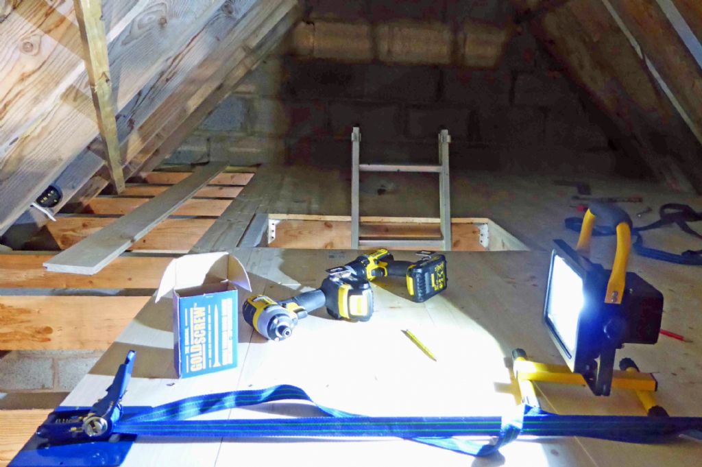

Photograph 13 shows a 10-Watt LED portable work light that has proved invaluable when I was installing T&G wooden flooring in my loft. It is powered by an internal rechargeable battery that can be recharged from the mains or from a car cigarette lighter socket. It has a single COB LED about the size of a postage stamp. It produces 900 Lm for 3 hours with a CRI of 70+ and a colour temperature of 5500K, ‘Cool White’. 90 Lm per watt seems to be the present limit of the LED technology for high powered LEDs. COB stands for ‘chips on board’ and is a method of mounting multiple chips spread out over a wider area to cut glare.
Since I bought this work light from Screwfix it has had a lot of use on all sorts of jobs around the house and workshop.
