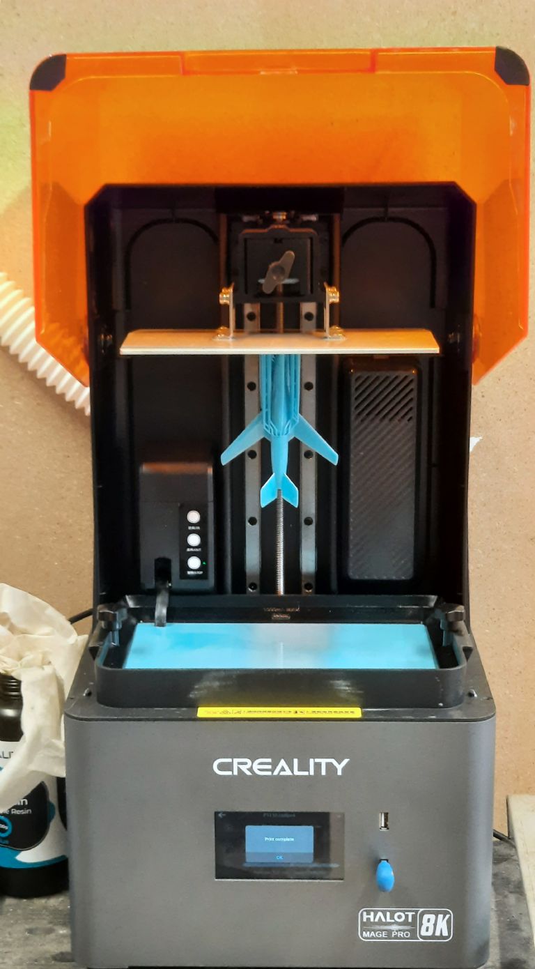

It’s a big, good-looking machine. The most noticeable feature of the Halot-Mage Pro is that instead of having a UV shield in the form of a large lift-off lid, it has pivoting guard that lifts up to give excellent access to the machine. The ‘Mage Arch’ is a great feature as it means you don’t have to reserve an area for the lid. This means you can use it in a similar amount of space as a smaller machine.

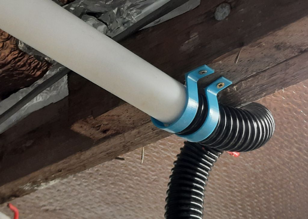

The Halot-Mage Pro has an integral carbon filter, much larger than the earlier printers. It also comes with an extendable vent tube. This makes using the machine indoors more practical as the pipe can be poked out of a window. The tube diameter is about 40mm. I fitted a piece of kitchen drain pipe to the rafters of my workshop and arranged it to vent through the rear wall. I then extended it using large diameter flexible pond hose. I designed pipe clips and pipe joiners in Alibre Atom 3D, and printed them on the Halot-Mage Pro. I’m pleased to say vent pump happily sustains air flow despite the whole run being about 4m of pipe. I plan to expand it so it can be used for general fume extraction when anodising, soldering or doing light brazing. I will add a fume hood on the end of a flexible tube with an integral fan, that I can suspend from the ceiling off a hook above any process. I realise this system won’t cope with hot air, but like a cooker hood it will mostly be sucking in cool air.

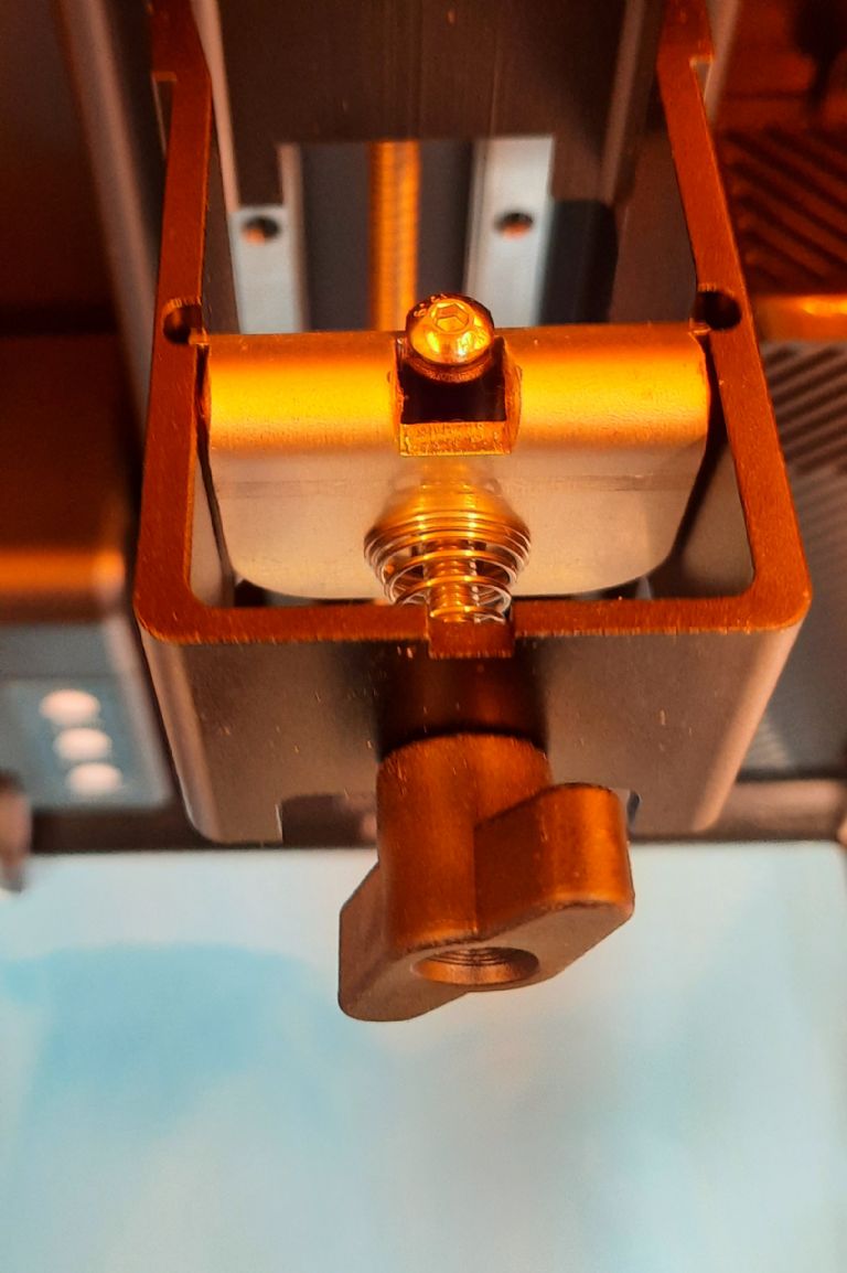

It’s a fairly small point, but the Halot-Mage Pro has an interesting clamp arrangement for the build plate; a knob at the front operates a cam that wedges the plate securely. This makes it easy to release and replace the build plate. Combined with the flip-up lid these oldest ideas make handing complete prints more straightforward.

One of my first prints was the set of pipe clips and joiners for the ventilation system in photo 6.

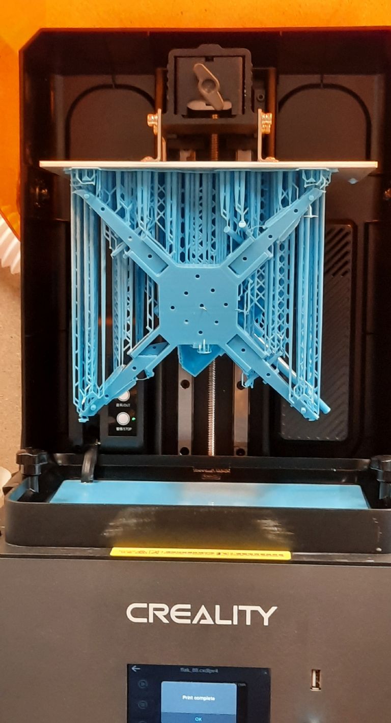

I tried printing a huge STL of a 88mm Flak 37 I downloaded from Thingiverse. This made use of almost all of the printer’s build volume. Unfortunately the ends of the legs did not print properly, this turned out to be a flaw in the model, not a fault of the printer – these parts had walls of zero thickness that didn’t print, and parts ‘joined’ to them obviously fell off. Aside from this the large and complex model printed perfectly.

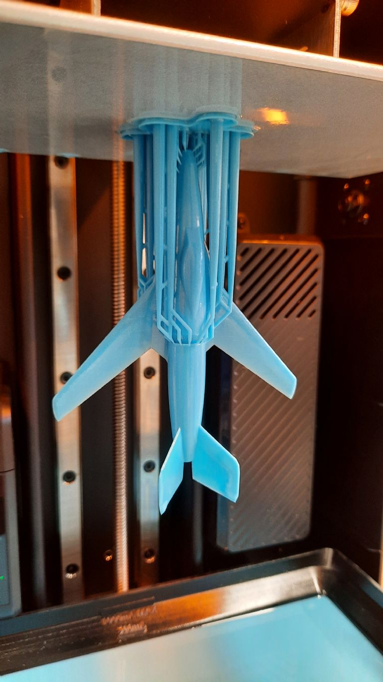

I mentioned a test of the same print on the Halot-Mage Pro and the Halot One-Pro, this was a 1:72 version of my P110 model, deliberately oriented to give a tall print. Speedwise, the Dynax mode was the difference between ‘this evening’ and ‘tomorrow morning’. To my eyes there wasn’t any noticeable difference in quality despite the print only taking a quarter of the time. What I would like to see is a somewhat tougher fast resin, as the Creality Fast Resin supplied for the test is in the ‘crisp but brittle’ category better suited to models than working parts – you might spot a small chip I broke off the wing when using forceps to handle the model.
